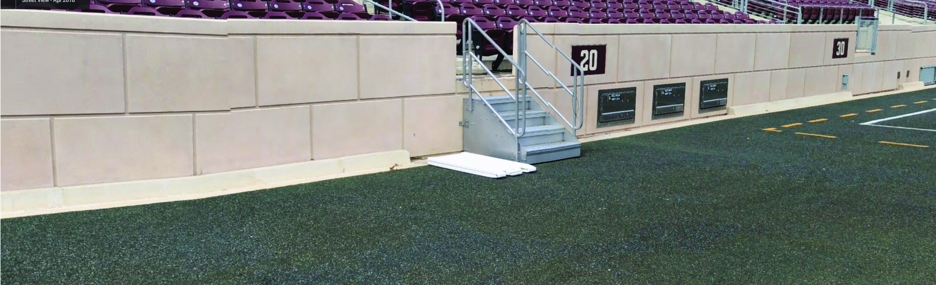

    Have a customer interested in potentially using a concrete wall around the interior of a stadium as ad space. They want the entire wall covered, but none of the outlets as you can see in the picture can be covered, and there are quite a few of them. My first thought was to have an aluminum frame made and stretch banner around it, but cutting all the outlets out of the banner sounds like a disaster waiting to happen... Also mulling the idea of using something like alumigraphics. Would be roughly 1300 linear feet and the wall is 5' tall.

    is concrete wall wrap vinyl an option? stuff sticks great, no drilling required.

    I agree that Alumigraphics or similar would be a good approach.

    I would be leaning towards just wrapping or using banners on that top tier, with maybe an occasional full length interspersed. Avoid the outlets and obstacles altogether.

    Would be a lot easier to do a banner frame or something similar along the top section only and would definitely make year to year switch outs a lot easier and cost effective. Think I will toss wrapping the full wall and then just doing the banner on the top at them and see what sticks. Thanks!

    I agree with frame system. All those panels will make wall wrap a pain.
