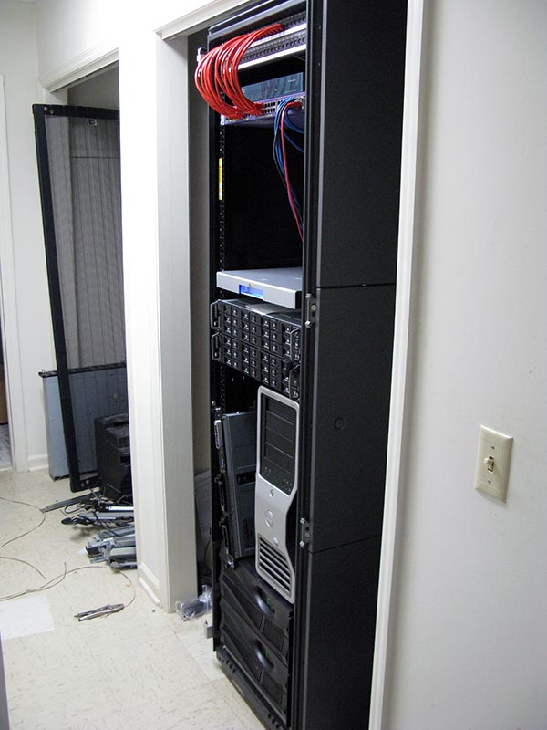

Recently added a Xyratex 36 drive SAN giving us 14TB of storage. After raid overhead it's about 7TB but the speed rivals single SSD's. :smile: Got it for dirt cheap (really ridiculously cheap - like under $300) and it was brand new unused gov't surplus. Currently has all 400GB 15k rpm SAS drives but it also supports SATA drives up to 2TB each giving it the raw potential for 72TB of storage. :omg: Also has a whopping 12 8GB fiber channel connections (4 per shelf.

this definitely is a great piece of hardware. but having all 36 slots populated running at 15k rpm sounds awfully like a power/cooling hog. :covereyes:

I should point that out. Each of the 3 shelfs has dual power supplies as well. As a whole the thing is fairly loud and puts out quite a bit of heat. We actually just moved and I have the server rack only partially setup still. One of the things I still need to do is put and exhaust blower in for the closet it is in. With the SAN, 2 cable modems, an 8 port phone modem, 48 port switch, router, firewall, 3 servers (also loud and hot), KVM, monitor, and 2 6000va UPS's the ambient temp in there is hovering around 80 with the closet doors on both sides open. I cannot close them right now or it will all overheat.
Another of my soon to do tasks is to configure a lot of power management abilities on the servers and the SAN. They can spin arrays of drives down after a period of inactivity and 2 of the servers can essentially go into sleep mode overnight. The "closet" is actually decent size with about 18" of room on each side of the rack. This is a shot of it as of now if you are curious. installed so far, the 2 UPS's on the bottom, temporary have a workstation sitting on the UPS's for testing as well as one of the servers (running), then 2 of the SAN shelves (both running, the other is sitting in the background on the floor on it's edge) then the rack monitor/keyboard (KVM on the back of that), up top is the switch, firewall, and patch panel. The other 2 servers are on the floor sorta behind the rack running. Hoping to make time this weekend to rack everything up and cleanup the mess.
