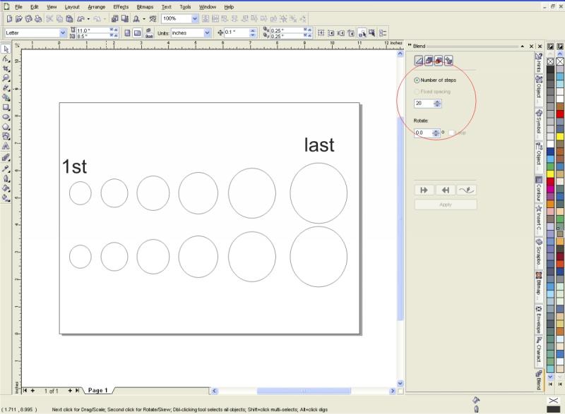

You have two options either align and distribute or the transformation docker, Also if you duplicate place the next time you duplicate it should be spaced the same in the same direction. Actually you could set the duplication offset to what you want!

try interactive blend...set the first one, set the last one at the size you want, blend with amount of changes...

Thanks guys. I believe the blend is gonna be the ticket, but I'm going to mess with the transformation some too. Thanks Mike
