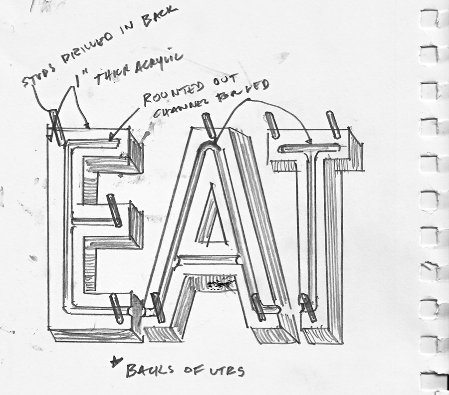

We have a client that wants the letters in picture below made out of the 1" thick acrylic and internally lit with neon effect and stud mounted onto white ceramic tile. I'm looking for your thoughts on how you would go about tackling this project? Here are my thoughts:
  1. Cut all letters out of 1/2" opal acrylic in 2 pieces with the rear one being hollow for rope LED and then glue them together.
I will keep adding to this thread with time and more ideas.

Seems to me it'd be easier to do them from a 1" thick sheet so you don't have to glue them together.
Cut on a CNC router, face down, after routing out a recess for the LEDs. This would enable you to drill precise stud locations, too.

Whats the overall size?
Do you have access to the back?
What effect are you looking for? Halo Lit?
