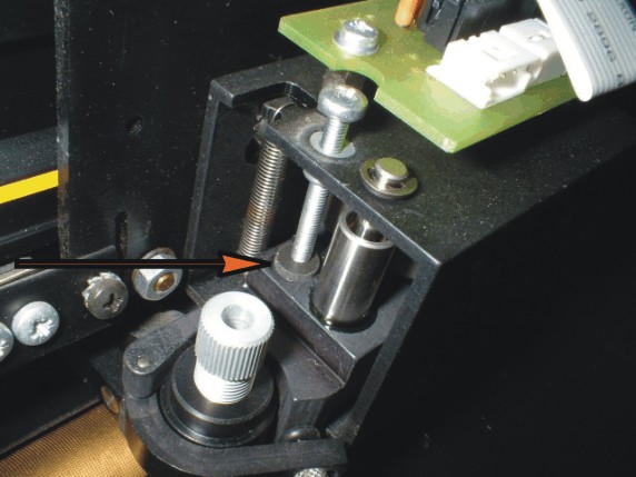

    I'll assume that your "T" model is the same in this respect to my "D" model.
    There is a plastic cover over the cutting head (affixed by 2 small phillips screws). Remove this cover, then you may find a very small (1/8" diameter) black rubber pad that a vertical adjustment screw bottoms out on. The adjustment screw over time makes a little indent in this pad and it can kinda stick there. If you very carefully remove this pad (it is glued down) and relocate it slightly so that the screw now comes down on a fresh part of the pad, you may find that this solves the problem.

    I had this happen for a while with my D750 and I called Summa. They directed me exactly as Colin said in his post. The "solenoid cushion" (part # HR29-134) had a hole almost all the way through it. After turning it over and re-gluing it with the other side up, my cutter cuts much better than it has in a LOOONG time. I did order the correct replacement today and the $8.00 small rubber pad is on the way :biggrin:

    First, you must remove the plastic cover as shown in "Pad 1".
    You can then see it........as shown in "Pad 2". It's a good idea to replace it every year or two, so get a few of 'em.

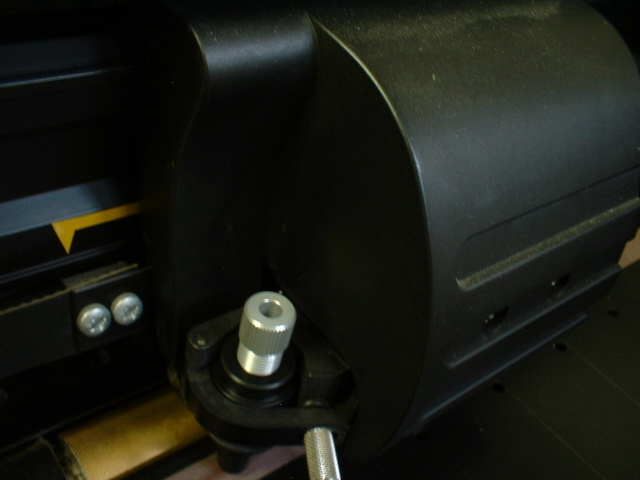

    T750 head vs the D750 head
    My T750 head looks quite different than the D750. One big difference is that the normal position of the T750 head is up where the normal position of the D750 head is down. I've attached are a couple of pics.
    Thanks gang.
    Tom

    Yes, that T-head sure is different. In it, there appears to be a cylindrical copper winding with a cover that moves up & down. I wonder if there's a piece of dust or debris in there causing it to stick?
