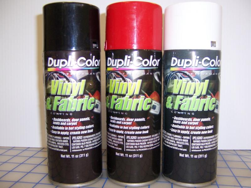

AUTO-FX
i have done some simple logos with stencils and upholstery & fabric spray cans. used the 70 denier nylon banner material. good for short term.
