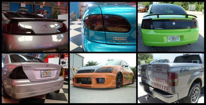

its either translucent vinyl or that's just how the tail light looks...
(going strictly from the picture) I have an impreza also, but not the WRX. Mine has red tail lights, but based on a very small amount of research the WRX looks like it has mostly clear tail lights. This could also be an aftermarket add-on light though...
(I am also assuming you are talking about the red around the outside of the tail light since I couldnt discern anything else that could be vinyl...)

Avery and (I think) LG also each have a translucent vinyl series... 3m most likely has a series also, since they have an entire line of tints and films...
grafxxx
ok sweet. that is what i thought it was i have some red transparent i will see how that bends. yeah they sell the kits for the sti's i have a customer that wants me to design tail lights covers and i wanted to make sure it wasn't tint.

I do alot of these for the import kids
I use avery translucent vinyl
Apply wet and heat gun takes some time but looks great
Did a red 07 z06 corvette yesterday
byt the way there is nothing on that taillight unless it is clear
I use colors smoke grey, red, yellow and ice blue

Yeah i do alot of these, i use oracal 8300 transparent film. you would be surprised how much you can stretch and wrap this stuff. it defiantly take some time to get used to the film and know your limits with it.

Looks like just a LED tailight in the pic?

the original pic is just LED's

The original photo in the first post is tinted with red translucent/transparent vinyl... The new Subaru s have an all clear taillight housing. This makes it look a billion times better. I doubt any cop would know the difference.
