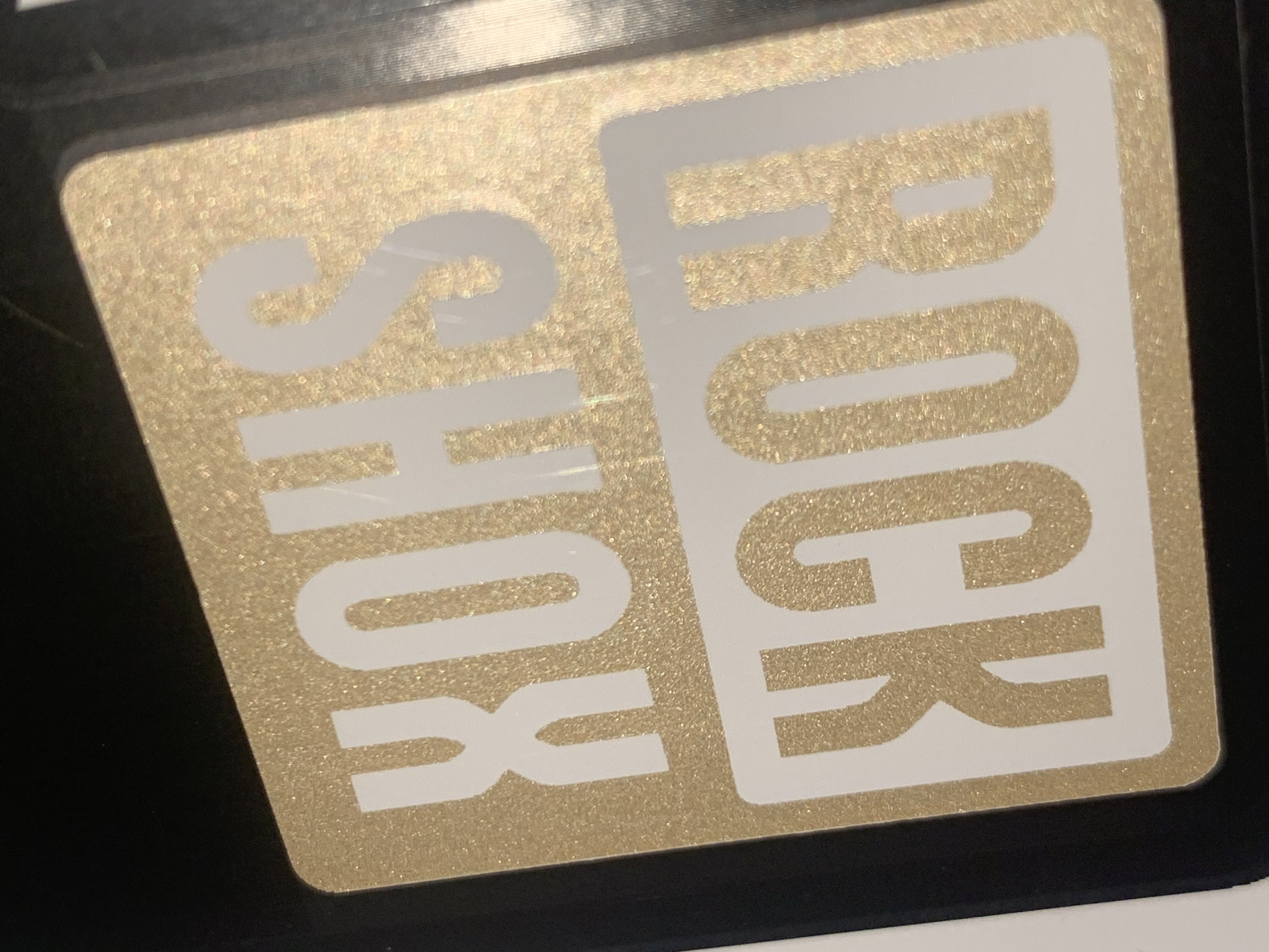

I am also fighting with the machine, its really nice but I did not managed to get good prints yet...specially because of this "shadowing" issue that I have with all the colors except with the gold and the silver. As you are also working with Flexi, it would be good if you can share if you have the same issue

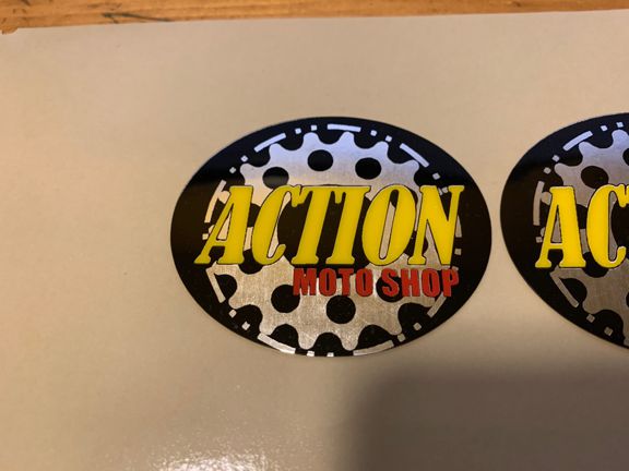

Network is working great. Prints every time, however my prints suck. I get lines, white spots and jagged edges. Of course I just been blowing thru junk vinyl figuring this thing out. It's probably the vinyl. Been cleaning the head off as directed and also been cleaning off the vinyl off with alcohol as well. The foils I got with the machine are old so that might have something to do with it.
