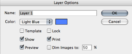

Double click the layer and make sure you have these settings.

I'm using CS2. When I double-click the layer, the only layer options are "show" and "lock". Maybe that changed with CS3?

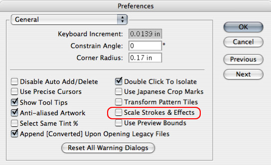

there is, in CS3 its under preferences, dunno bout CS2

rdm01
There is a setting that makes the stroke scale with the object. If that is not on, the stroke remains the same size no matter how you scale the object. Both ways have their uses, but in this case you would want it set to scale the stroke with the object so that they are not to thin to print.
Border
Yup, that's it! Trouble is, I had it set that way, but not until AFTER I had scaled the template up..... So......Problem solved.
