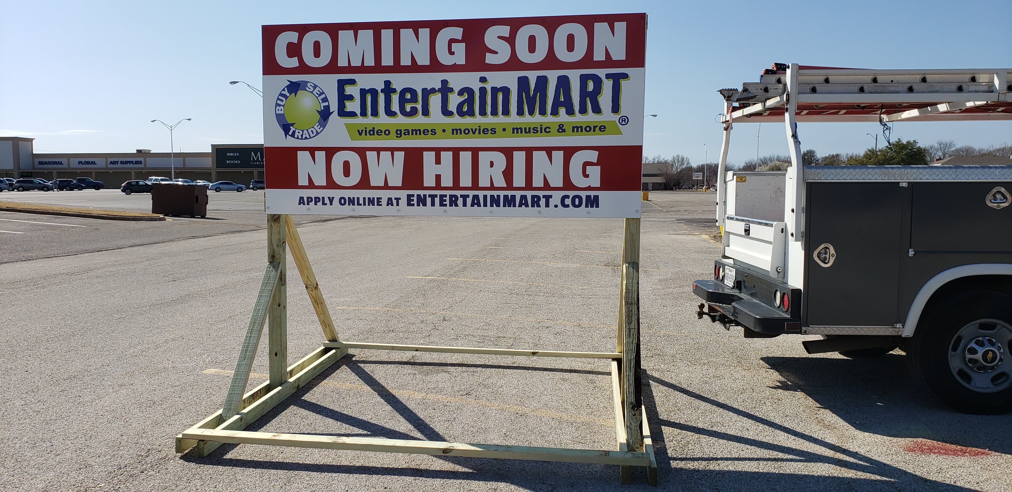

Here's a pic of a temporary frame a client built for their sign. Landlord wouldn't let them sink any posts into the ground, so this one just sits on top of the grass.

Skid sign might actually be the way to go. Do you know of any source online that has building instructions for it?

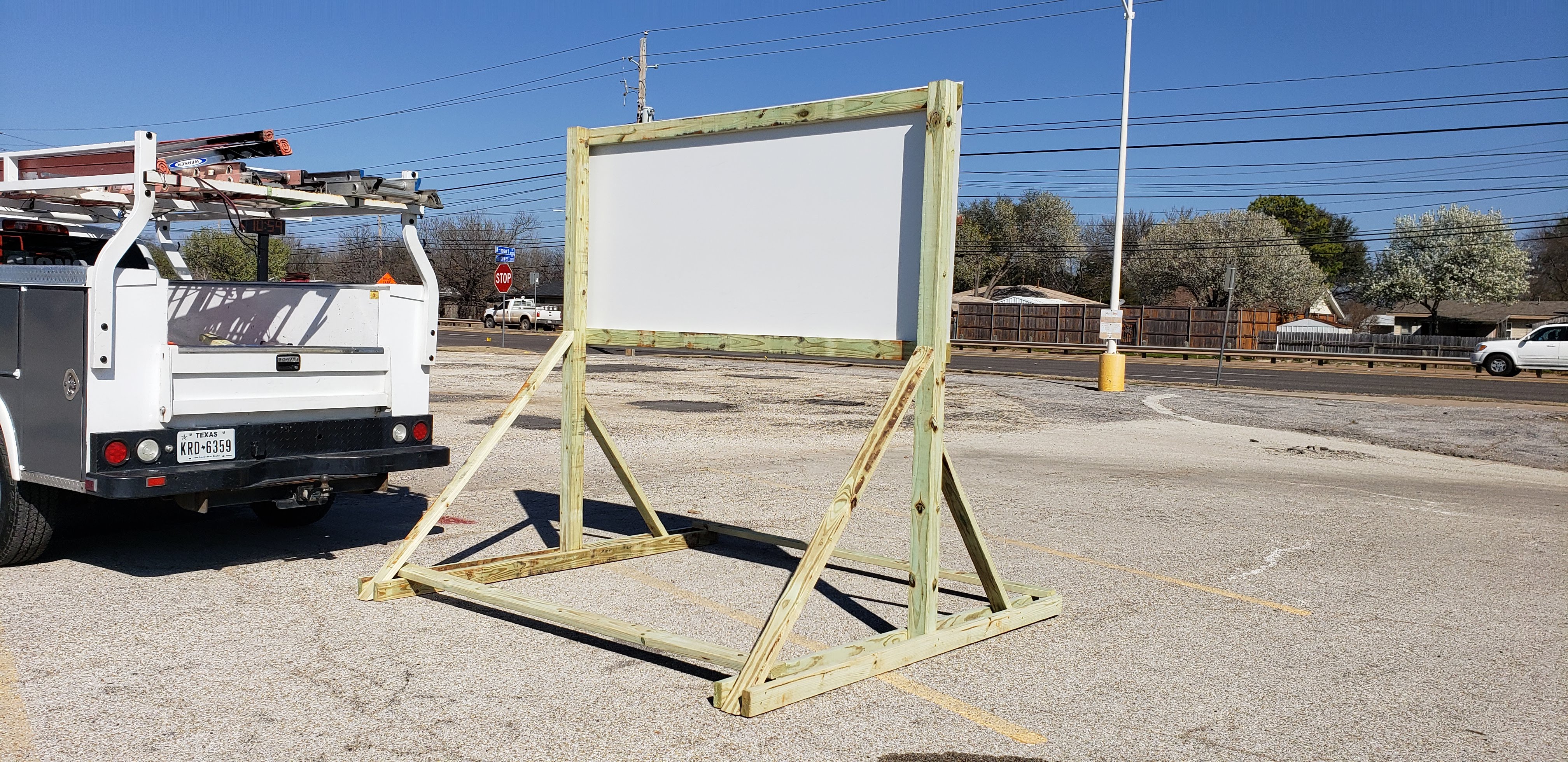

This was really rushed and I could of done better but it was a down and dirty temp sign. Just slap another panel on back and its double sided.
View attachment 149255 View attachment 149256
