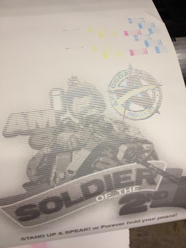

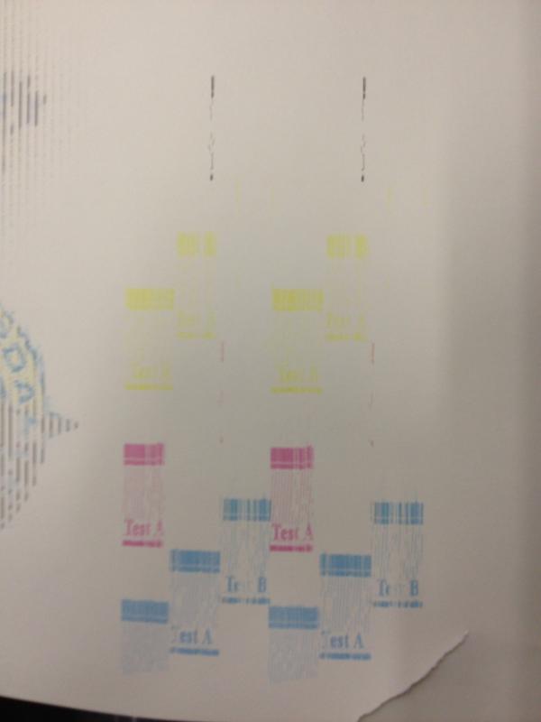

Here is a sample of the output...
You have to get the air out of the lines and you have to stop the leaks in the dampers before you can evaluate.
Air will cause the head to sputter, over spray and print erratically. Leaks will also cause similar issues. I can see quite a bit of overspray in your test images.

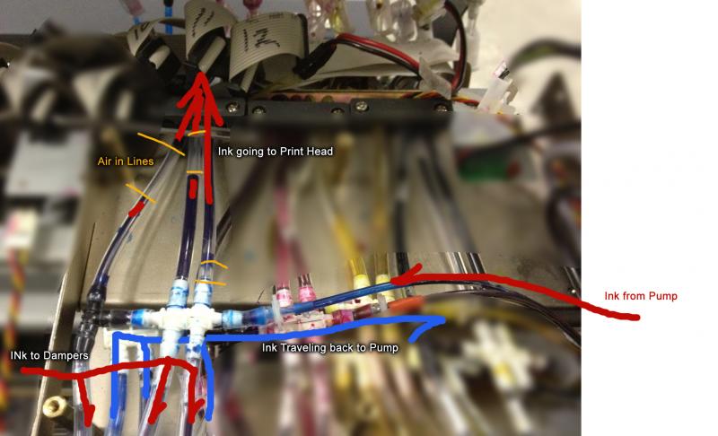

StopSignGraphics... Great insight, a little about this system - the pumps are pushing ink towards the print heads, the ink then either goes into the heads or is diverted into the damper. Ive attached an image that I have diagrammed to explain the ink flow for this system.
As far as the ink, as per another thread here on signs101 - I purchased 1 gallon of Cellosolve, 1 gallon of Carbitol and 1 gallon of acetone and have created my own "cleaning solution" but for now as an alternative to ink, I have mixed the Cellosolve (15%) and Carbitol (65%) with some ink (20%) just for color so I can at least see the basic result of the output.
At this point I am still trying to remove the air from the lines while trying to find the location of where the air is being introduced into the lines. I am beginning to suspect a possible location is at the needle where the bulk ink cartridges are inserted and/or from the NEW dampers. I also have a request into Graphtec for OEM ink cartridges since I do not have any.
I'll post again when I can confirm.
"Mike Paul" This system does not have o rings at the dampers - see image...

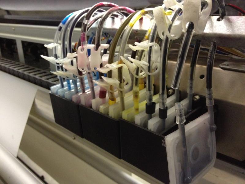

Did you remove the cleat things? If they are factory they should be there, whatever they are.
Also are your dampers OEM or cheap knock-offs? My Roland tech tells me the cheap ones don't have proper filtering and can let debris into the heads which is a bad thing...
How much help is Graphtec? Surely there must be someone who used to work on them you could talk to?
x126
"Player" After working my way through a few different offices and people - I finally did make contact with someone there. I am communicating with them as well, but I'm one of those types who can't stay Idle and wait - therefor I figured plugging into the wealth of knowledge here is a good thing. I'll admit - I am looking forward to resolving my issues so that I may be able to lend a hand to someone here in the near future.
Prior to actually making contact with Graphtec, I purchased a few items that were not OEM from http://www.benjercorp.com/dampers/ and the dampers were one of those things. AND YES! I agree they are cheap demonstrated by the fact that 4 of the 12 leaked, also they are dampers for a HP9000 Seiko 64S & OCE CS606 that was the closest match I could find. As a matter of fact - the previous owner also used one of these same dampers - thats how I figured out which alternative to use.
Cleat things????? Can you clarify

In one of your other threads you asked about some things in the lines that were clogged and if you could eliminate them.

I'm really confused by the photos. What purpose can the dampers serve if the ink goes through a 6 way fully able to bypass them? In all printers I have seen the ink must first go through the dampers then into the heads. It appears as though there is a 6 way fitting which allows the ink to really just bypass the dampers.
I don't have nor do I have experience with the type machine you have but on most other ones I have seen the ink flow is this-
cartridges (or bulk tanks) > dampers > printheads > capping station > pump(s) > waste tank
sometimes there might be a filter somewhere before the heads and/or splitters dividing the ink channel to multiple head channels of the same color. I'm sure there are other designs as well which probably have the pumps in-line (positive pressure pushing ink to the heads versus negative pressure setup after the heads pulling ink) before the heads.
