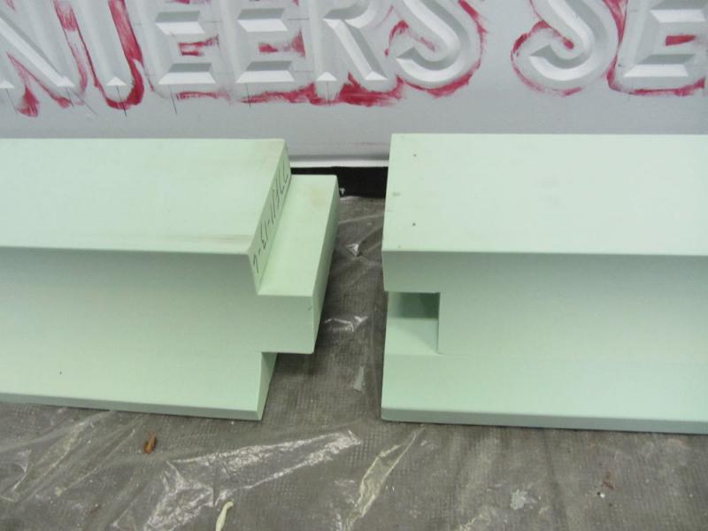

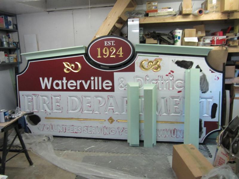

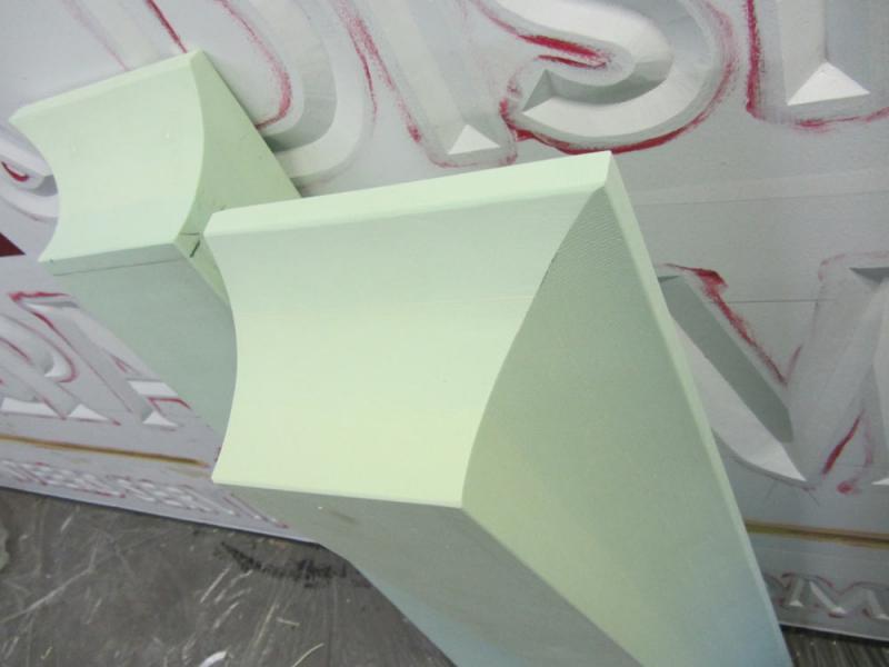

Just finished making some big molding for a fairly large carved sign. I used a table saw to make the cove by running the molding sideways across the blade. The molding is 8" x 5". The long run is 11 feet and I knew I couldn't miter the ends with my bandsaw if they were that long so I broke it down into 3 sections with tongue and groove joints.
I'll post up a picture of the sign once it's installed. The sign is 12' x 5' ish.

What material are you using? I have some samples of precision board that I hope to test soon.
signmeup
That's Corafoam by Duna. 15 pound HDU. Nice stuff. I switched to it years ago. Really like the way it works.

I saw the technique years ago in a woodworking book. It took quite a few passes because the saw blade won't cut below it's teeth. I had to do 1/8" at a time.
I glued up the blanks for the molding in "stair step" fashion so not as much had to be hogged out. I was surprised at how smooth it came out though. I didn't have to sand the molding at all.
The nice thing about Duna foam is they added something to it to make the dust fall right to the floor. It's amazing how well it works. I was dreading this job because I figured it would be "dust hell" but it was fine.
