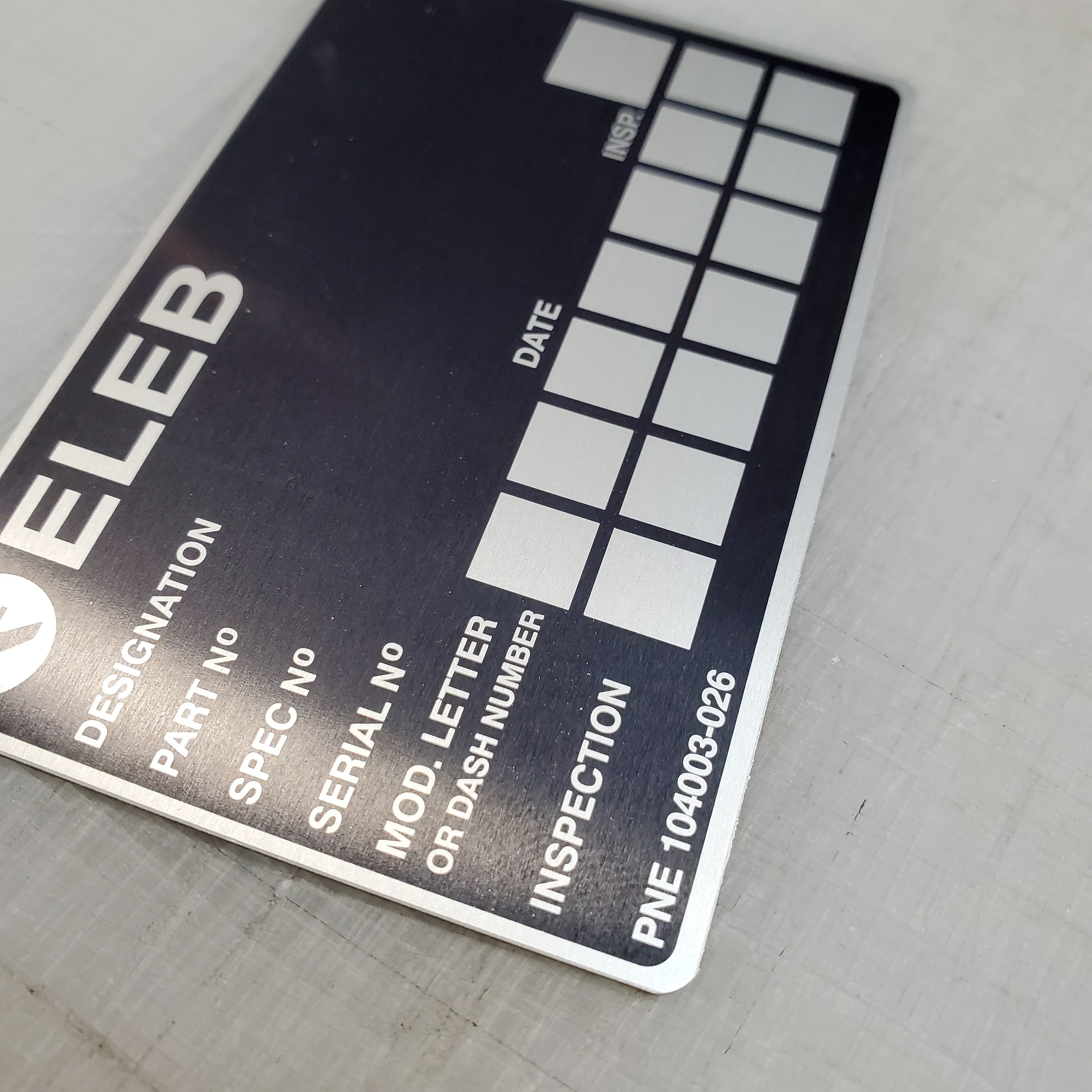

No texture, the surface is totally smooth. Tried scratching the black with something sharp and it took a lot of effort to leave a mark. Agree that the laminate is just a protective film, it peeled off easily. Customer probably removes it when they apply the plaques. I'll check out JDS, thanks. Didn't know they did wholesale production!
they are metal photo process.
rossmosh
JDS will not do this process. At best, they'll offer sublimated on aluminum, which will not match. Johnsons Plastic would likely be a better option for small quantity runs but even then, I'm not sure if they'll be a big help.
Gemini who bought ID Plates would be the best place to go. Gemini has really hiked up their rates on this type of product so be forewarned.
This is simply a die cut plate with silkscreening and then a plastic slip sheet applied afterwards. The plate is then stamped, punched or engraved afterwards.
EDIT: Pete probably is right that they are "Metalphoto" or some similar process. Still something Gemini can do out of their Texas (ID Plates) facility most likely.
gnubler
Thanks for all the suggestions. Are these all retail places? Customer is already getting these from somewhere so I'm going to pass on the bid if I can't find a wholesaler. I looked into Gemini and they don't offer what I think I'm looking for, and the customer is wanting a plate thinner than .020 if possible. Agree that this is probably the Metalphoto process.

All of you are supposed to be grizzled sign people and not one of you recognizes a dye sub print?
Boudica
How can you be so certain just from the photo? It looks like it could have come off our UV flatbed printer.
CanuckSigns
Possibly because it's not dye-sub? Dye-sub doesn't hold up in industrial environments, the plate in the photo is MetalPhoto, we order a ton of them
gnubler
Gemini describes their dye-sub plates as interior use. These get attached to outdoor fuel tanks so definitely need to be durable and resistant. I'm still thinking MetalPhoto.
