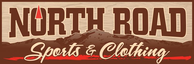

I had to use this new letter style to see what it would look like
Well, I like that font .... but not for there. Something solid/classic/dependable looking is what I'm thinking for that part of the name. The compass behind the mountain is a possibility though it's moved from the forefront to the far background. I like the font you used on the first sports & clothing. I was just looking for it through my font book. I know I have it on one of these many disks I've got.

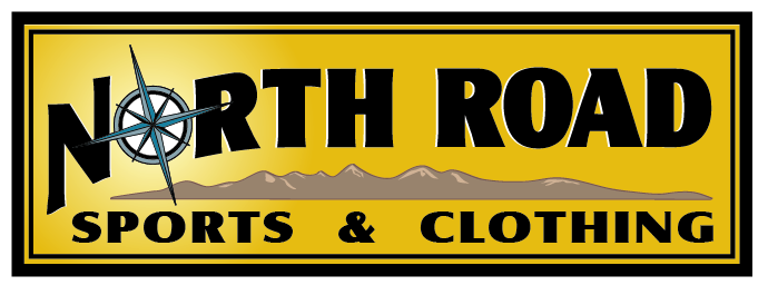

i like the direction Day Sign Co is going in the first sample they posted. the angle concept that the OP is trying to incorporate just isn't working on this one for me.

I love Mike Jackson's work also but so far I've never been able to interest a customer in that kind of style. Day Sign Co's first contribution is my favorite even if the compass for the O has been dropped (that was the client's first thought on what they'd like in their design).
Luggnut, the concept of no distortions without a reason is a good one that I'll keep in mind.
I like many of these suggestions as to the layout, but none of them say '3D' look to me. When we do sandblasted or carved signs.... they generally have a unique shape. By unique, I don't necessarily mean crazy like-all over the place, but not just a rectangle. This looks more like a regular flat type of sign layout for MDO or aluminum…. or even a backlit.
With relief signs… we tend to make the style do the work and keep the layout somewhat simple. We like to show off the beauty of the wood and the technique being used. That all goes into the designing, unless someone gives us straight forward directions, thren we do as told, collect our money and say goodbye.

My initial impression when I reviewed the original post... the text skews and angles were clashing and not complimenting each other. I think the full compass hurts the legibility as well.
I liked the mountain range idea that Day Sign introduced.

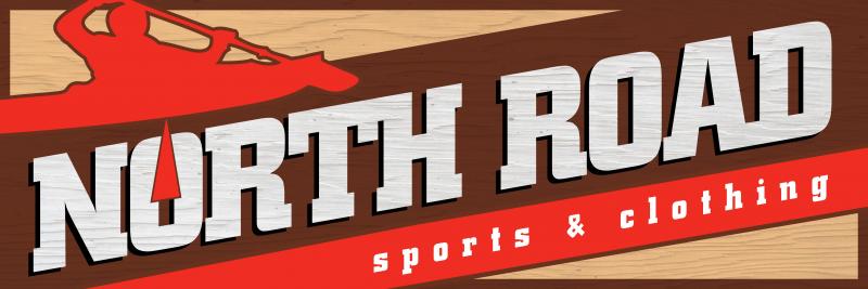

I think the reason for my original distortion was to impart a sense of movement (not necessarily perspective). I'm still after that in the attached new take on a layout (though I'm still tempted to go with something close to Day Sign Co's contribution).
