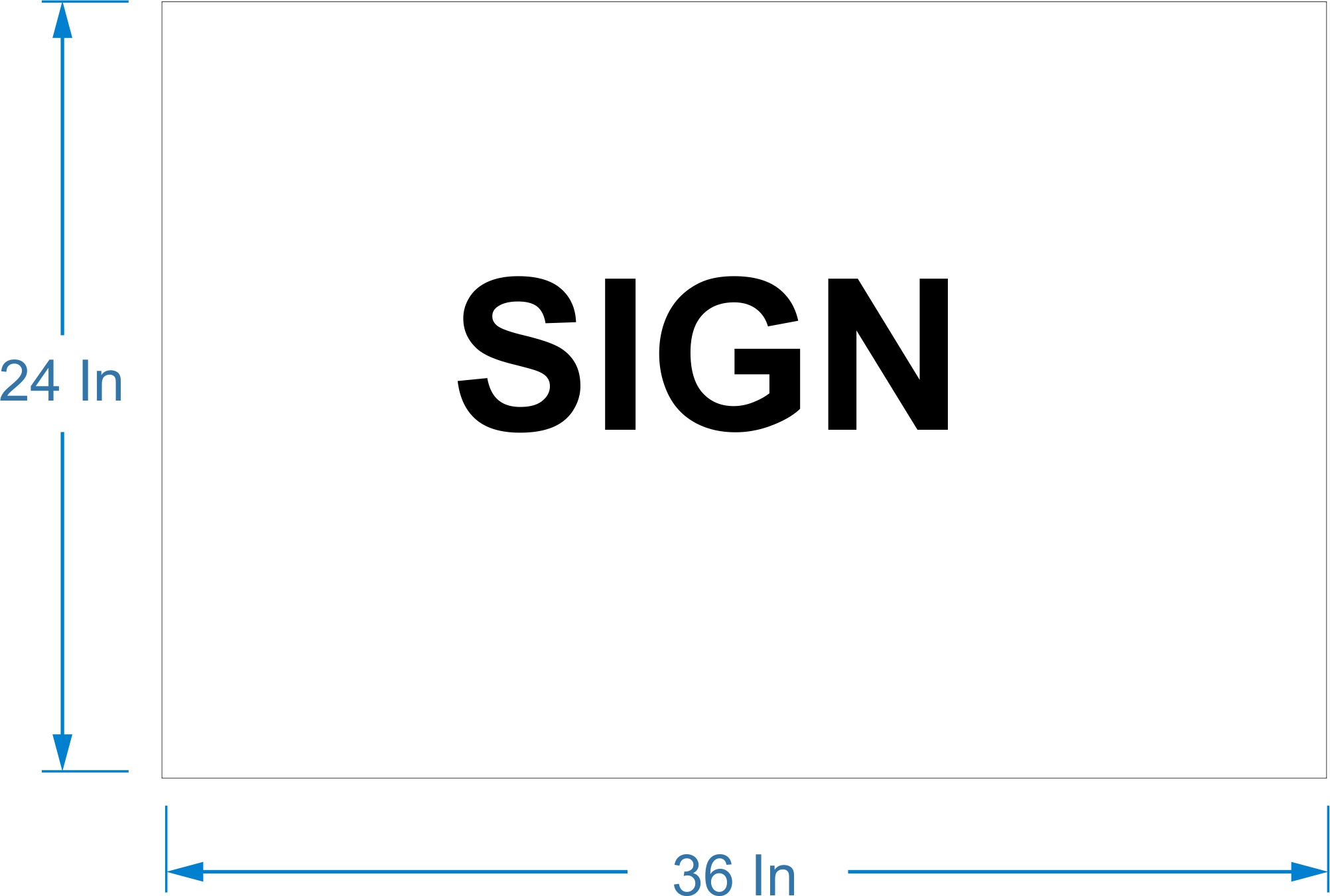

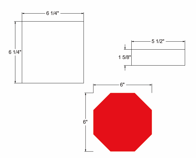

This is not an answer to the question, but I've got to where I always add dimensions to my proofs (like alot of other people do) I send to my customer to clarify the height and width they will be getting.
I work in CorelDraw and just made a file named measuring lines and saved it with the lines with hairlines that stay the width same no matter the size I make them and with editable numbers.
I copy and paste the file into my design each time and scale the lines to fit and change the numbers.
It saves alot of confusion when the customer can see the actual Height and Width around the sign or decal design itself.
It's hard for them to come back and say I got the measurements wrong after approving the design.

I use a Corel Macro to drop in the dimension lines. Select my sign blank then hit the letter d and bam.
