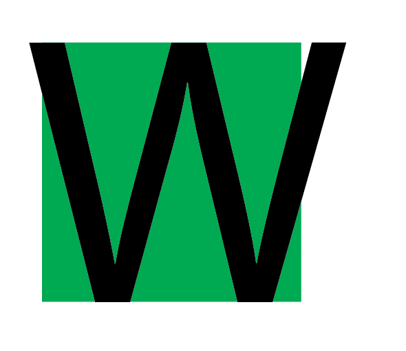

If I want a 1 inch tall letter I just create a 1 inch tall box, make it a light color. Then type out some text and place the cap letter on top of the box and adjust the point size until it matches

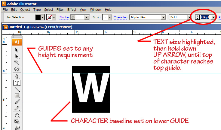

I simply use the RULER (CTL-R) and set two horizontal guide lines at 10mm or 1" apart (whatever), set text cursor (baseline) on the bottom guide with the TYPE TOOL, type "W", highlight the text size, and simply press the UP ARROW KEY or hold it down, the text will enlarge very quickly till the top of the character reaches the top guide (the bottom of the character stays on the lower guide), then stop holding down the the UP ARROW, and now you have any character, any font set to any cap height, ascender or descender the exact height you want in a matter of seconds.
No copying, or saving font files for different sizes, no drawing boxes, etc, the guides can stay for reference, because they don't print.
Quick and fast...
