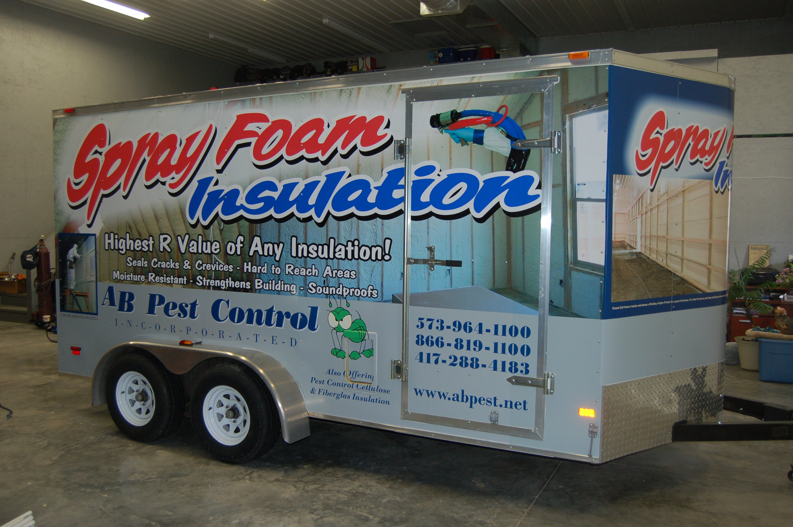

Are the screws really bothersome?
Not on that they are not...at least to me. Maybe that's why Toad said on a case-by-case basis.
They were on this puppy... I wrapped the whole thing in white instead of the customer repainting it. Painting the screws made it look a lot cleaner. Can you find the one screw I missed? Lol
