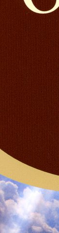

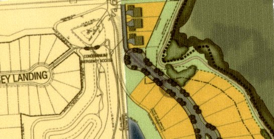

Problem. Images that contain dark areas will show what looks like white bands. Lighter shaded areas will not show this banding. See the two images. Notice the white bands in the dark areas?
I've adjusted the feed adjust and can't get rid of this white band. I'm assuming that by using wave the banding would be a sine wave type of band not a straight line band. I can use the rip to print unidirectional at the finest setting and the bands will still show up however the space between then is smaller.

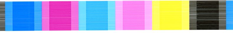

Nozzle check is fine. I booted the printer into maintenance mode and ran some tests. The third image is from the Front and back test. Again I'm assuming that the blocks are supposed to be solid colors. If this is the case does anyone have any suggestions?

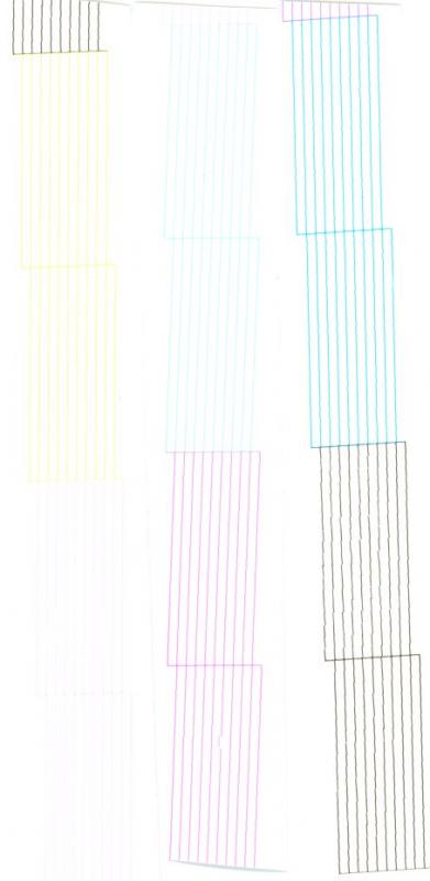

Fresh nozzle check
Here's a nozzle check. To me it looks good. There's one missing bit on the magenta head. The black shows some deflection.

solved....
It appears that I have fixed the problem with the banding issue. The problem was either the black print head, which I replaced, the PF adjustment that was out 1 mm or the encoder strip which was cleaned. I'm guessing the black print head was the main cause. So far the Mutoh is printing without those nasty white lines.
