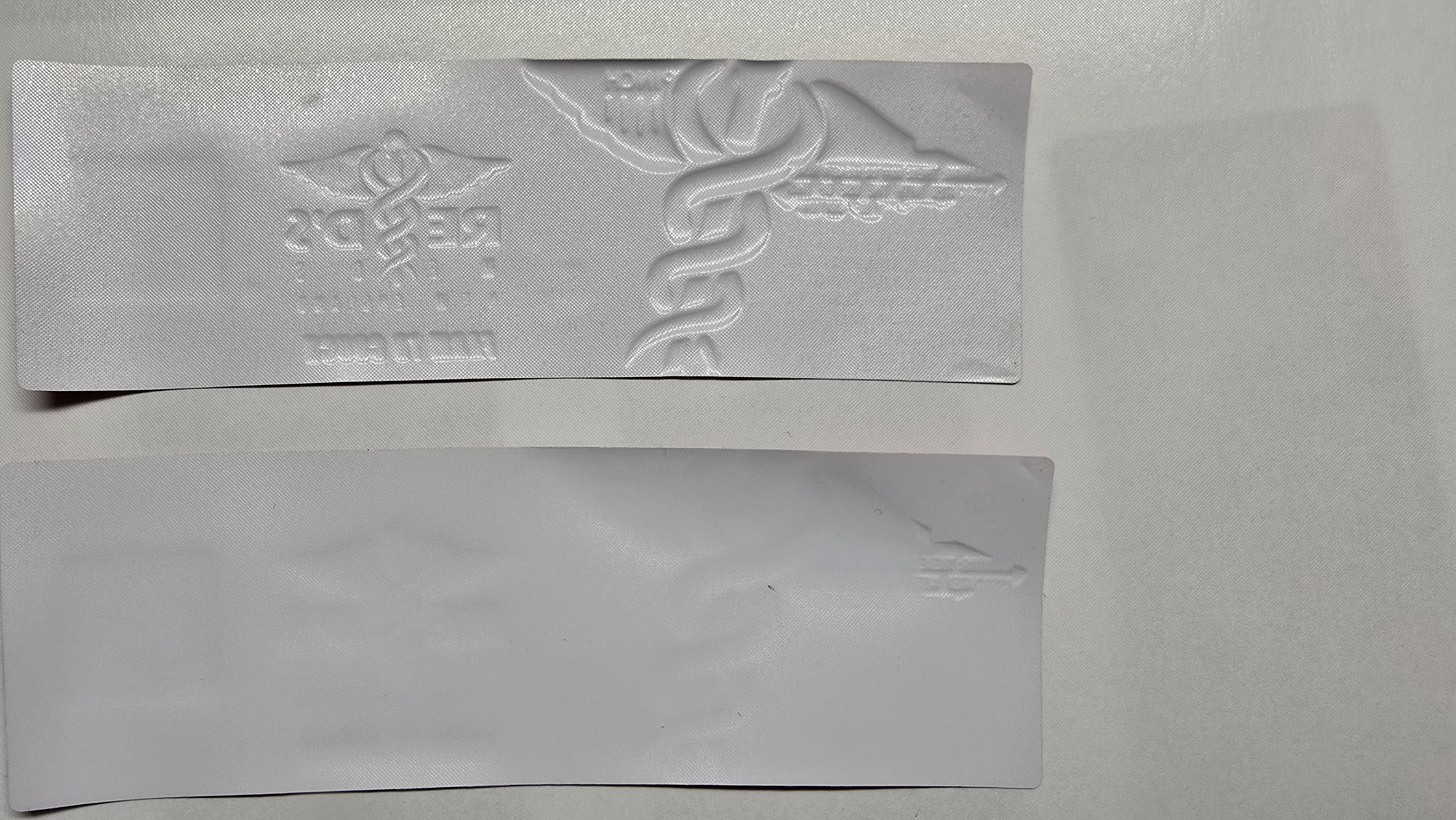

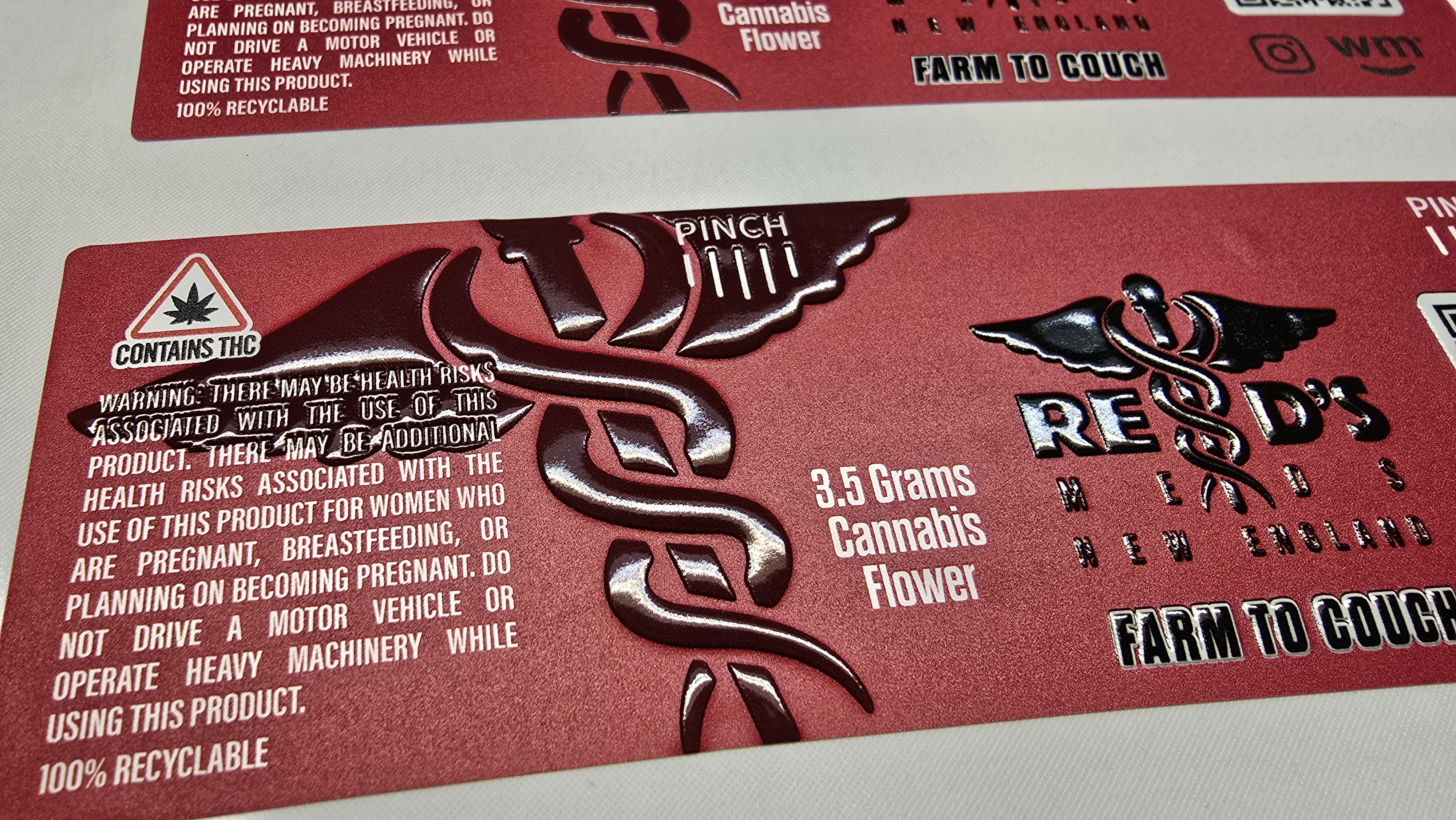

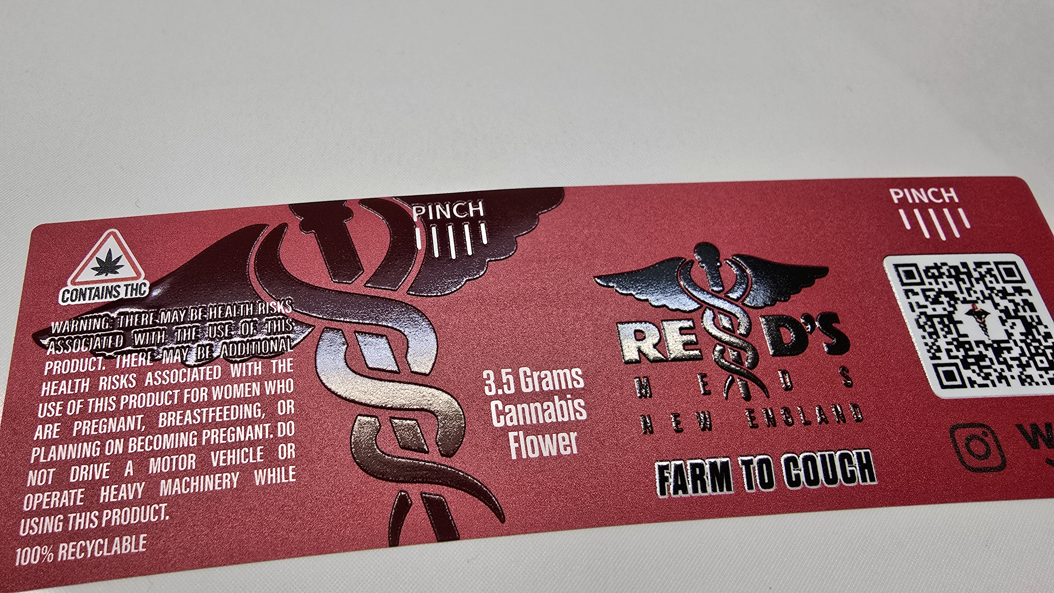

I'm curious if anyone else has encountered this issue with UV prints and clear gloss/matte ink. It doesn't happen consistently on every single piece but happens to at least some pieces on every clear job I run.
The initial prints come out looking fine but within a couple of days I notice this "puffing" where the clear ink has laid down. If I look at the back of the vinyl the places where the clear ink is you can see it makes this concave area in the vinyl. When the label is on a items it sucks the vinyl right off the item it's supposed to be adhered to.
Really trying to figure out if this is something I'm doing or something with the vinyl.

dinomaskot
I haven't noticed that. I'll keep an eye on some stickers that I have in the shop, and will report back on monday if I have any like this.
I noticed that the vinyl is "raised" only when i did the 2.5D
Air release vinyl is more susceptible to this. Also, if you lower your UV adjustment it fries it a little less. STS Clear inks has changed the game for me personally. For what it's worth I think the puff effect looks pretty cool lol. More of that Roland, rounded gloss look.
I'll have to really experiment with settings or switch to a non-air release to help prevent it. My machine is still under warranty and don't want to void that so switching inks isn't in my book just yet.
It would be fine it it did it evenly to everything, but when only certain areas do it it really makes it look not so great.
Lexjet has an HP gloss permanent adhesive vinyl I'm pretty happy with, also doing work for cannabis brands and clients seem happy with quality. Also heard General Formulations 216 (which they also carry for cheaper than the HP) is great. Both non-air release. I've always personally found non-air release to be much easier to weed as well, but maybe a bit harder to dial in cuts since the backing is generally thinner IME.

Right now I use Substance 3755 Matte AR. I think I'll get a roll of non-ar to try.
Also what was weird is that a Mimaki rep told me when buying this never to use more than 50% clear ink. Then a few weeks ago I was told to try it at 90-100%. lol
Those photos I posted were done with a pass of 100% of CMYK and white under the regular 4 color then a pullback with 90% clear gloss.
Yeah lowering your gloss level will help too, then you can also lower your UV lamp setting. my theory is it's something to do with how the gloss ink + UV lamp reacts to the vinyl that makes it puff like that.
