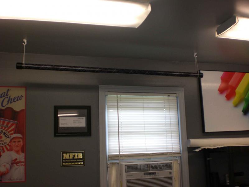

Or they hang their prints?? I made some cheapo hangers from pvc tubing, some string and some heavy duty drywall hooks, (see attachement) and hung them close to the walls so they are out of the way and they work perfect. Maybe it is just me, but I would be leery covering a print. I don't think it will properly out-gas correctly. Dust isn't going to hurt anything.. Don't you gently wipe down your prints as the feed through you laminator with a microfiber towel anyway?... I can just foresee you having problems with the laminate lifting from the print work long term.
