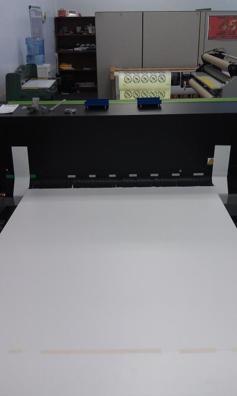

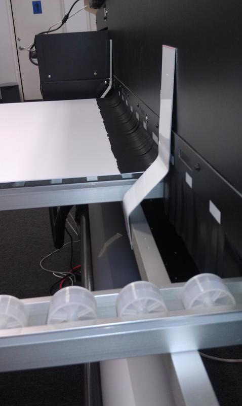

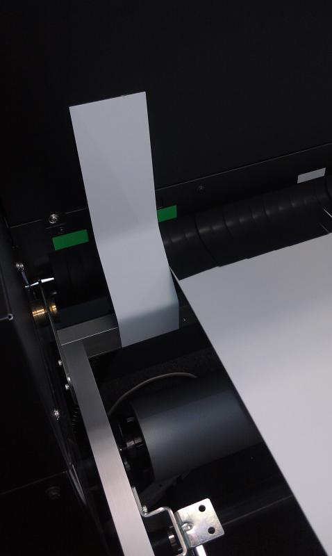

we have been running our uvj for a few months now and it works great but as a lot of people on here said the roller feed can cause you parts to be off a little. i am printing an .060 styrene job two sided so this is where it needs to be accurate. printed the first sheet and it was off left/right about .125 to .150 so i bent up some .050 alum. put adhesive on the ends and hooked up these guides now it is righ on the money
