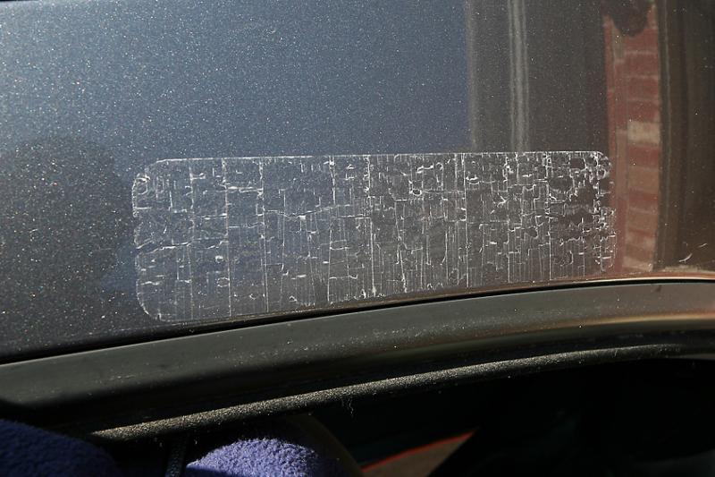

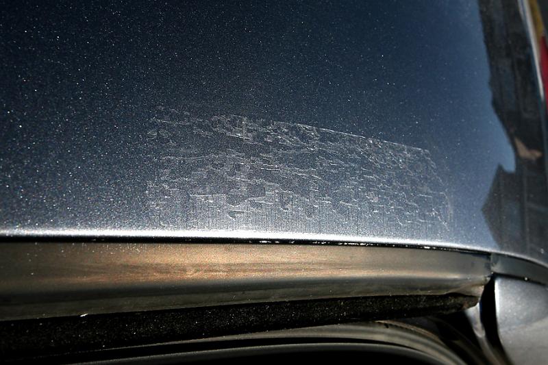

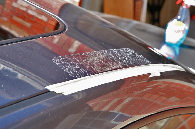

I just picked up a used car for a daily to get around in for a great deal, however, the previous owner must have had a cheap roof rack on the car that came with cheap clear vinyl pads to put on the roof for protection. Car is 5 years old and I'm guessing these were on the whole time. Its not just a matter of breaking /chipping when you try to peel it up, they are already cracked into a million pieces.
I've tried every tool I have here, heat, vinyl scrapers/lifters, solvents, etoh etc. I've managed to get some of it off getting the best results using a combination of "Vinyl - Off" and 99% Etoh although leaving the solvent on there to soak looks like it may ba affecting the clear coat a bit and I'm afraid to try anymore.
I do not have access to a "vinyl zapper" or similar tool.
Does anyone have any other suggestions?
Pics for reference.

Brands Imaging
wet sand 1000 grit and buff...
maybe 600/800 - although if its an older vehicle you might not have much clear left on it..
you might need to send it to the body shop.
bjones
if there's still glue or vinyl there wet sanding will destroy the paint. There's no way you're going to sand off the glue and not hit paint. Use something like goo gone or another citrus based adhesive remover and a hair dryer.
Jester1167
My guess is its not vinyl, it's clear polyester. Old cheap poly cracks just like that and is a pain to remove. My vote would be on the citrus based removers. You will have to soak it and scrape it repeatedly.

Well, having a bit of success with steam. Using a very basic houshold type bathroom steam sprayer and spray for a few seconds, then scrape, then spray, then scrape. Spraying long enough to soften the vinyl/poly to scrape away at it but not long enough to hurt the paint hopefully. Taken me about an hour right now and am about 70% through one pad.
Well, back to it then.
PS. tried Goo Gone, didnt really work.
