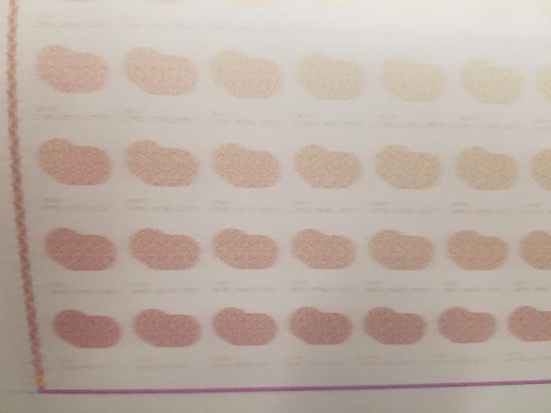

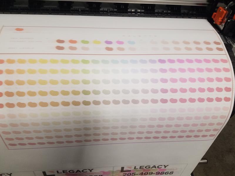

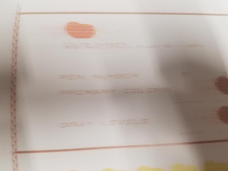

Working on this for a friend. The printer started printing horribly. I replaced the maintenance station, didnt help. Im assuming clogged nozzles, the nozzle check only prints about an inch of lines. Pics attached. Any insight would be greatly appreciated!!

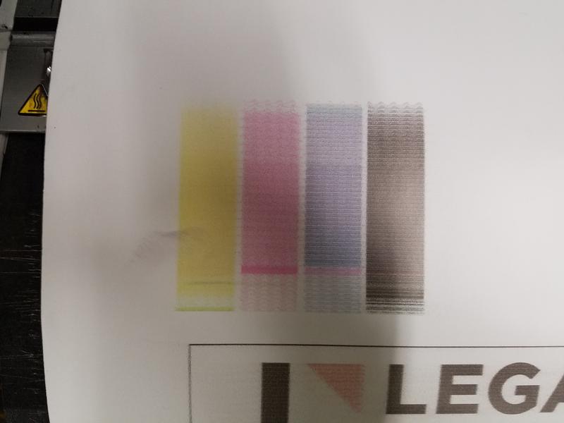

This is what the nozzle check looks like. Going to try the other suggestions today. Thanks for the input guys!
heyskull
There is your problem in a nut shell.
That looks like a hell of a lot of nozzles blocked for something to just start printing like this.
That looks like it has been blocked for a long time.
How old is the print head and is the machine used much, as these machines thrive on a lot of use?
I would check that the cap is sealing properly onto the bottom of the head and listen for leaks when cleaning.
This is probably nothing to do with head cables or encoder strips.
I would leave the head soaking in solvent cleaning fluid overnight.
Then give a few strong cleans and see if their is an improvement.
Then report back.

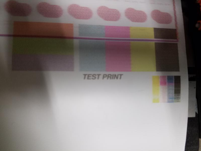

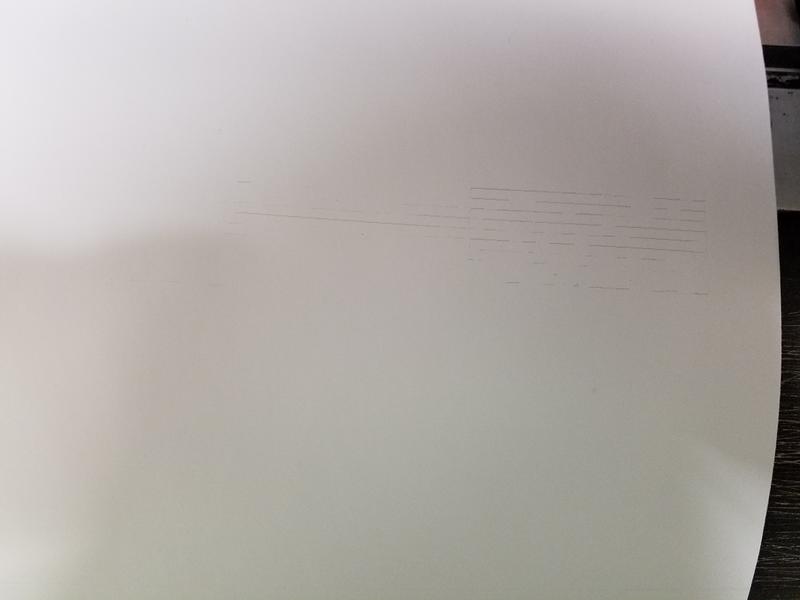

Did a headsoak for an hour, then tried a few test prints just to see what happened. Here are the results

It's used on a daily basis, but it has NEVER been cleaned before. I thought the same thing, but it was printing fine last week, because I had him print me a banner. These guys have had it for 3 years, and they bought it used. So who knows how long since it has been cleaned, and to top it off, they're using some cheap aftermarket cartridges.

Soak overnight then post a nozzle test print.
The head can let go at any time but that looks like ink starvation or the pump is not pulling through properly.
