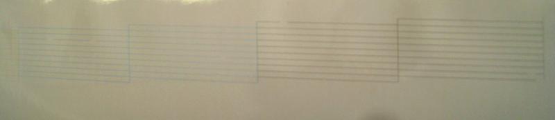

Well here is an attachment of my test print.
Magenta and yellow are perfect.
But I have a couple out on the black and the cyan as pictured.
Could this be creating me problems printing blues as they are coming out purple.
I can't believe having this few out would cause so much problems.

When printing blues and greens their is fine lines through it.
It is as if the small amount of nozzles are making a huger difference.
It doesn't matter what setting or quality I have the machine set on the problem is still there.

Hmmm... I have the same cutter. I'm understanding this now as when the pf adjust is made so that it prints accurate to measure, the lines show up. When the pf is made to make the best print, it is too inaccurate for the plotter to read. Sounds like those missing nozzles aren't so bad you can't "hide" them using the pf adjust, but are bad enough to cause the situation. I can't think of a remedy other than getting those nozzles to fire!
