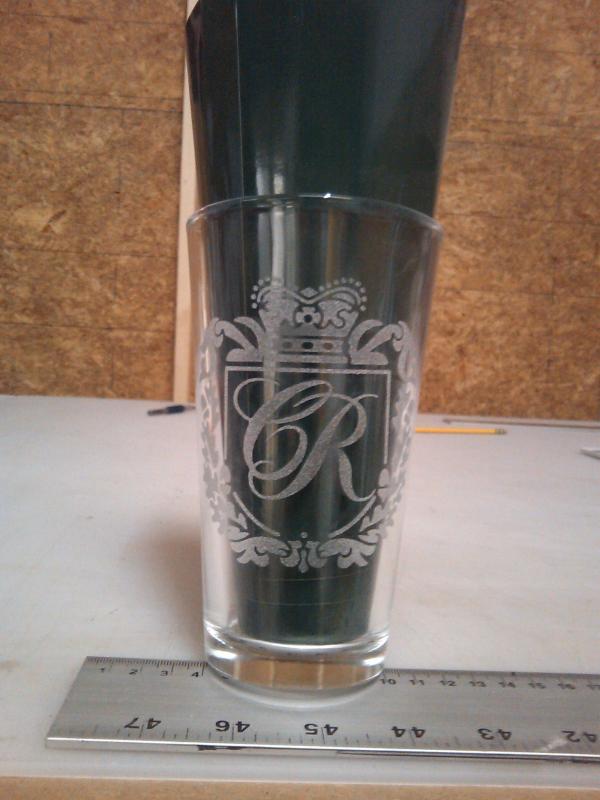

Same with me. Small sandblasting cabinet max size 24x48. But it will add convenience to your shop. I don't have to wait then is commercial blaster available today or in three days and a lot of times my projects under 2 sq ft. Plus I etch glass.
well my experience goes to if you want to start sandblasting go with cabinet if you limited on space, blasting media (coal slag or aluminum oxide) and compressor with minimum of 18 cfm at 90 psi and 40 or more lb blasting pot.

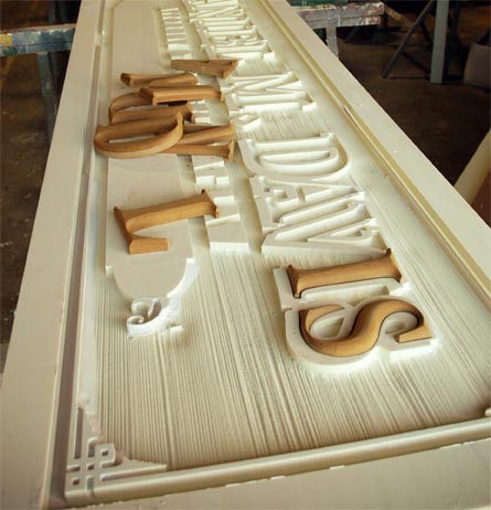

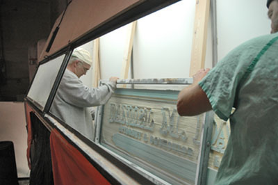

I've blasted for twenty years until I bough a CNC.
Our air was and electric twin screw with a 11' blast cabinet which I made. As good as it was all of blasting and prep work is time consuming and dangerous.
Now I set the file up and let the router do the work at night while I sleep. The compressor, pot and cabinet sets out back, abandoned.

Have you given your CNC any wood texturing jobs? When I caught onto texturing with my router, the sandblast work was a thing of the past.
There are several not too expensive programs available. Although it takes time to learn. I can post a few examples if you would like.
