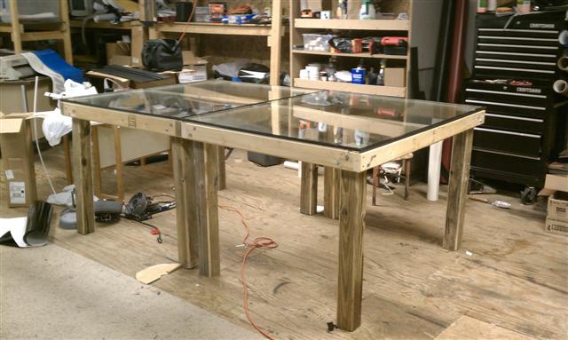

I'm making some smaller units that can be rolled around and joined together. The only reason for the size (5'x4') is that I snagged 4 5'x4' unframed windows for cheap. I've had a regular table for the past 3 years and I forgot how much I missed working on glass... the cuts are like butter and won't scratch, it cleans easy and it can double as a light table.
Here's a picture as they are currently ( and only 2) I plan on painting them, adding a shelf below and adding casters. Excuse the mess, its a work in progress.

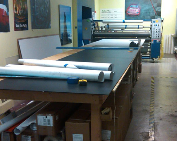

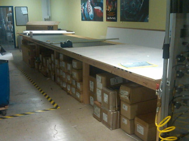

here are some tables.
Long table 64" x 32 feet We use this for laminator that we use for wraps and then trim panels.

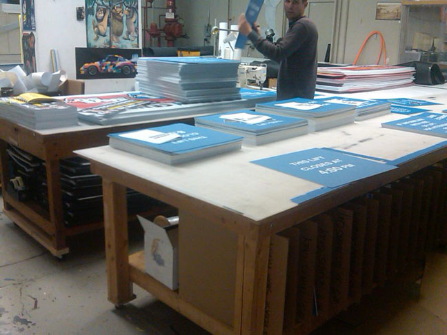

Smaller tables we use for finishing and kitting. These are all on casters and can be configured as needed.
Hope that gives you some direction on how to build.
