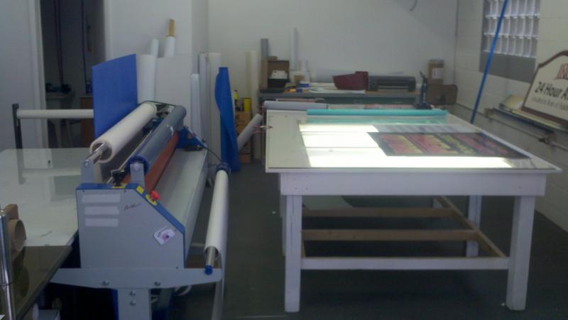

Here is a 5x10 that I just built pretty much out of scraps from around the shop. I put 3 2x4 light fixtures in it and covered it with a piece of glass that I got from a storefront that replaced all their windows. It's not tempered but it's doing the trick for free for now! If I get a chance here soon I will try and set up some building plans for it. The light table really comes in handy!
