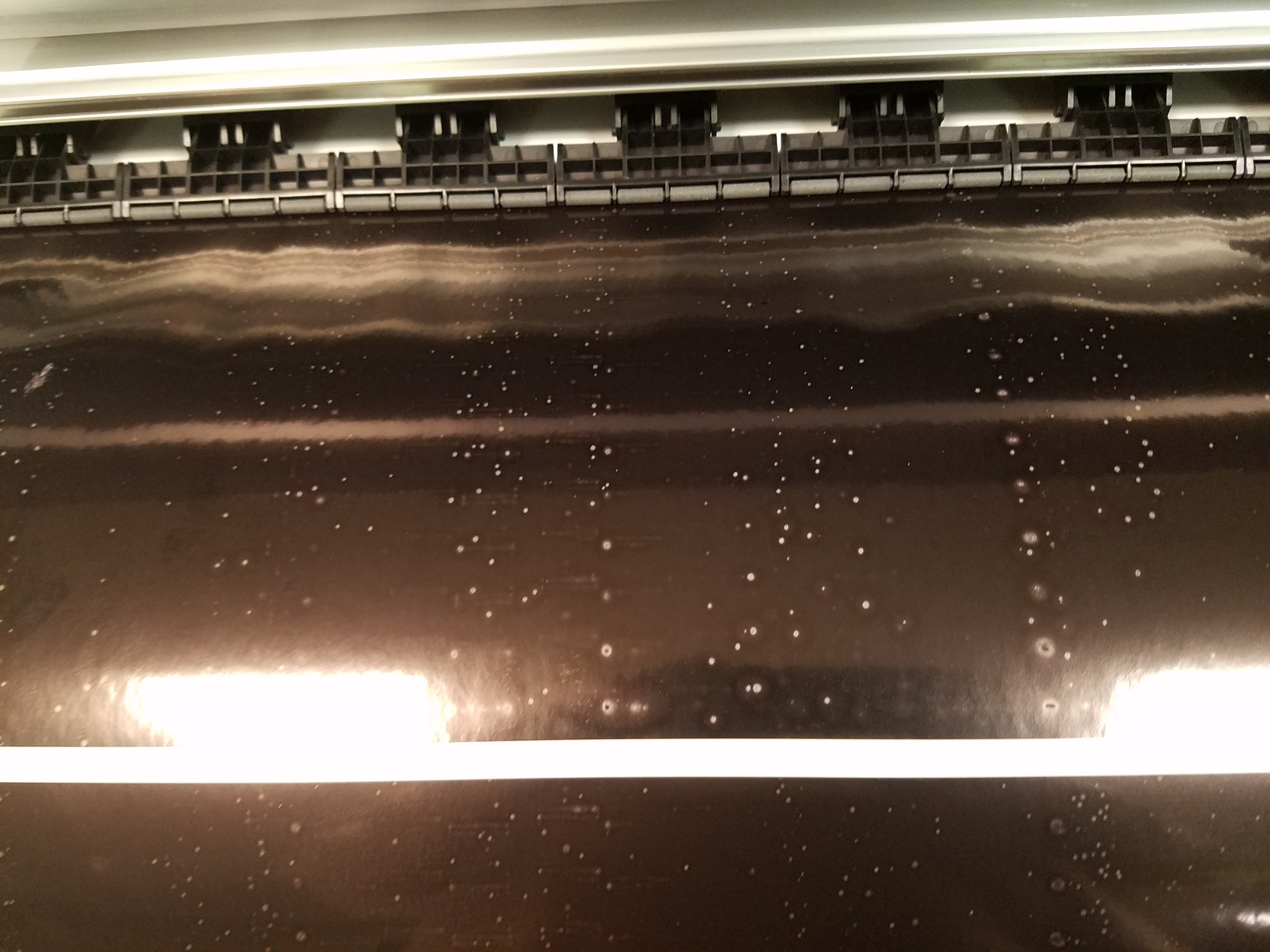

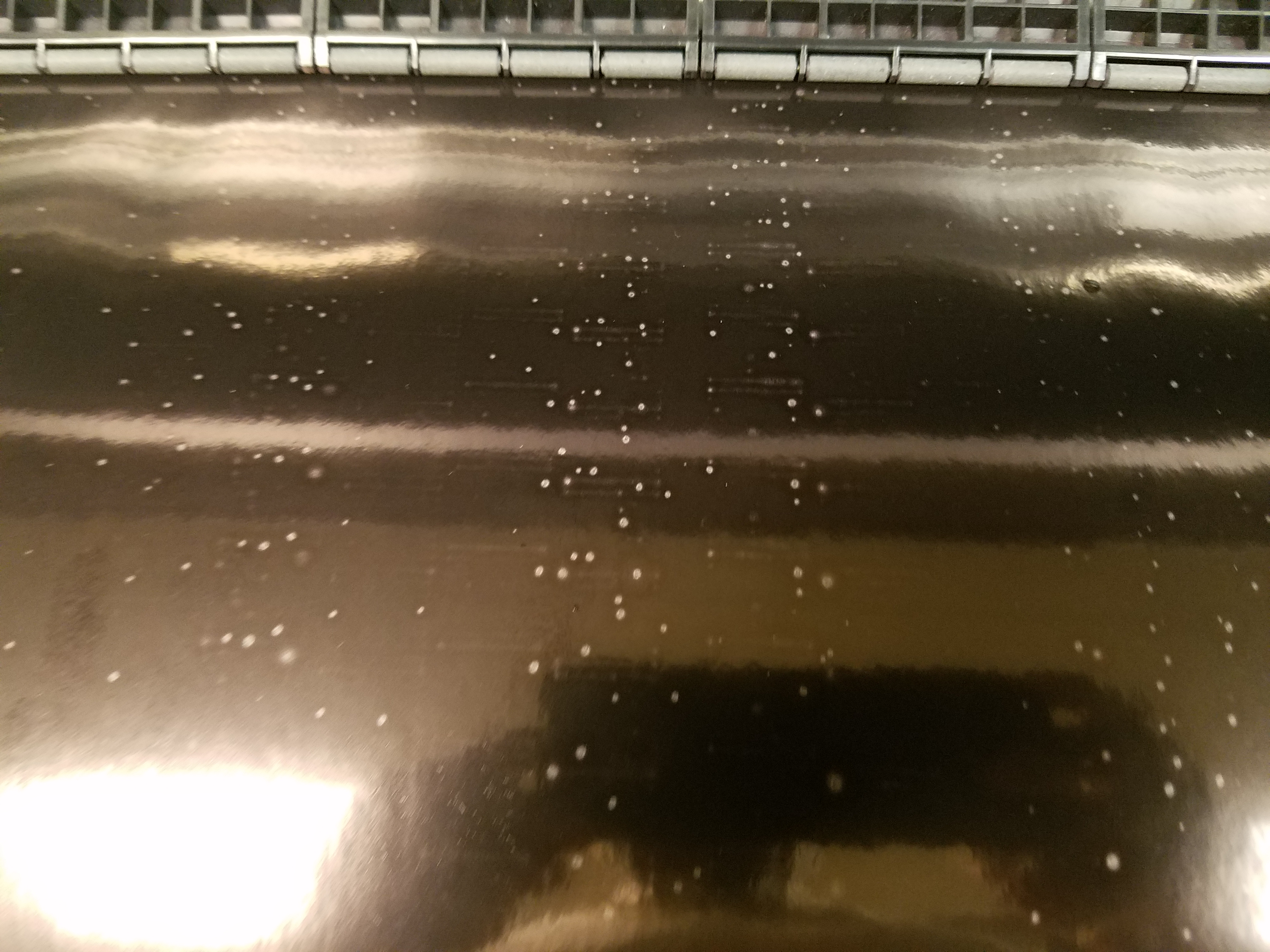

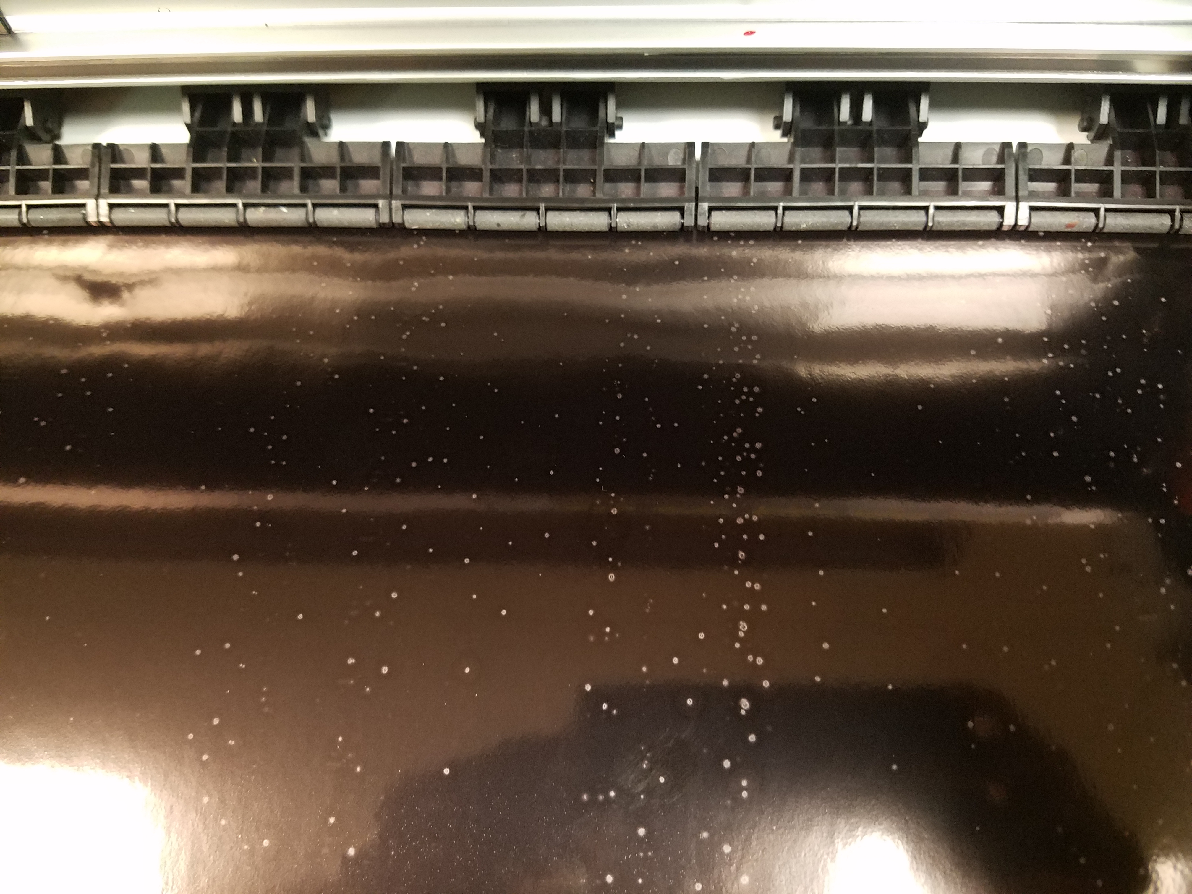

This matter is getting more and more interesting by the day! I've tried (I think) every suggestion made here and yet things appear to be getting worse instead of better. Posted are the latest pics today... here is yet more new self adhesive so I'm convinced now it has nothing to do with the media. I heat was cranked up here and a 1440 icc profile was used.
Looking at the patterns it's making now leads me to believe it has something to do with the rollers. Take a look at the pics where I pulled the print back up to the rollers... they match up almost perfectly. I do know if perhaps some of the silicone grease leaked down on them and now they are rolling some sort of film over the media before the ink hits it preventing the ink from adhering to the at area. But again... why is only the black affected??? Can you affectively clean the rollers or replacement is the only option?

It may sound stupid but did you actually physically check if the print area is hot? Drying area may have separate heating elements.
1440 dpi AND unidir will slow the printing down even further, I'd give it a try to see what effect does that give
what the
Owner/op
Its definitely not media- the dot pattern is systematic and too perfect. Could be the memory chip on the print head.. I think you mentioned this a new head.. Possibly the connection got jolted and need a reinstall or a defected head?

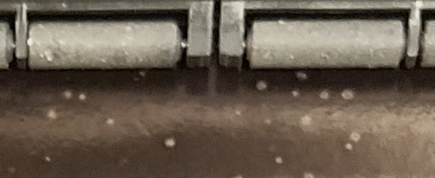

What's the crud on your pinch wheels? Have you cleaned them?
I'm not familiar with your printer, why is your print behind the pinch wheels?
Did you back it up or does it print that way?
ubeny
Hey Andy D! My printer is a Mutoh vj1324... and yes, I backed it up to show that the patterns seem to line up with the wheels... and yes, I "attempted" to clean them after this pic actually. What's the most effective way you've found to clean them?
henryp
Looks like the pressure rollers are contaminated. Use a rag moistened with Eco solvent cleaning fluid to wipe and clean the rollers. If that does not fix the problem, replace them.
