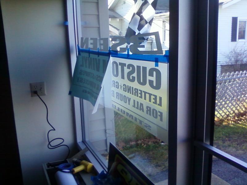

I install dry when I can and wet when I have to. I'll always use the hinge method when I can too. Once I get it all stuck down, I'll cut vertical slits where I can so I only have to hinge pieces of manageable size instead of doing the whole thing. Hinge from top....squeegee down.
This is a great thread.
Below is a pic of what I mean from the other day.
