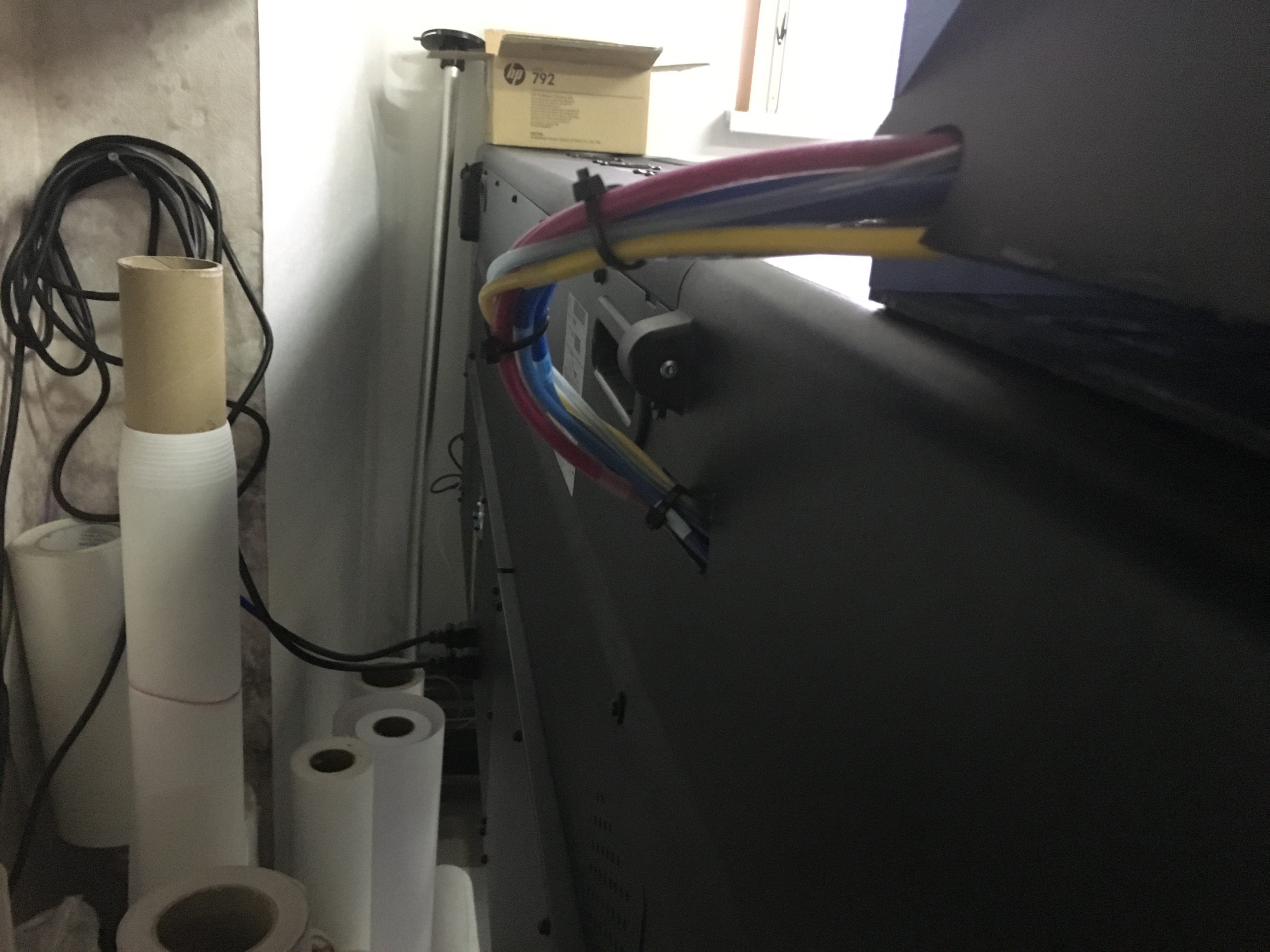

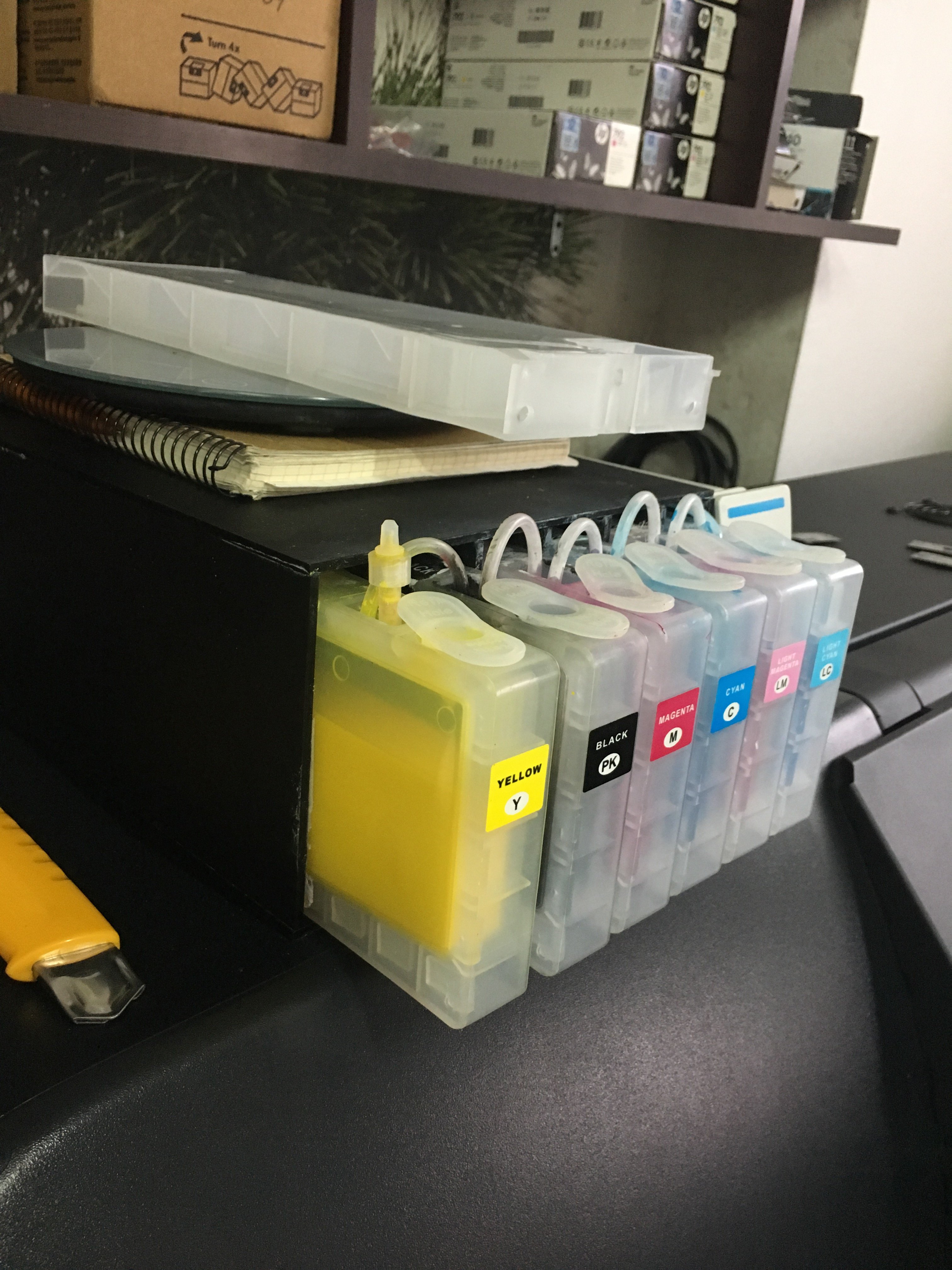

But at the same time, it is possible to use consumables from the 300 series. Ink works without optimizer, you only need to force the printer to accept 831 cartridges (chips from aliexpress or carefully read the user manual and make the printer work with "empty" cartridges). It is more difficult with the printheads, since they have different colors. But I know that some people buy a light printhead, wash it with distilled water, glue the chip from the old (not working) printhead and rearrange the ink port. So you can prolong the agony, but as for me it is better to update the park with new HP Latex, they do not just stain the media, you can earn money on them.

Yeah alright okay. No clue who would want to waste their time doing all this but I guess it's possible....
