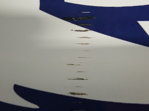

Any know what would cause these marks in the middle of my prints???
Thanks
Thanks
Its not on every print, but it seems like its on the first print after it sits for more than a couple hours. the wiper blade is pretty worn, would that cause this issue?
Thanks

I could not really see the test print very well. Were all the heads firing?
One thing to keep in mind, for any service on the machine you will have to call EPSON and then they send a tech out for the repair(s). Printhead replacement runs about $2500.00 I would think given that, you would be able to call Epson and get a service report for the machine. Other than having to replace a printead on each machine, they have been very bullet proof.
