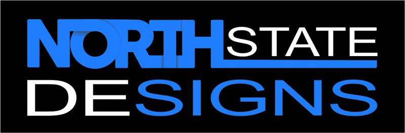

What do you guys think??
Warlick Designs
thoughts??
TDFcustomSL
Personally, Im not feeling all the overlapping on the word NORTH. I see an 0, and I and Im not sure what else. Make the T look like a T....
Maybe move the arrow to another letter? Like the leg of the N or the H....

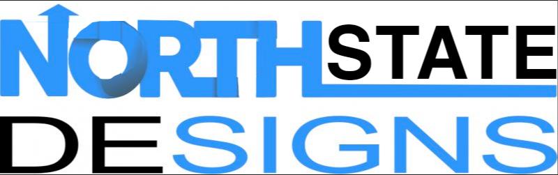

gritsonis
arrow goes to the N in north.
the stroke on "state" and "designs" looks way stretched, i fixed the lettering for STATE but too lazy to fix designs.

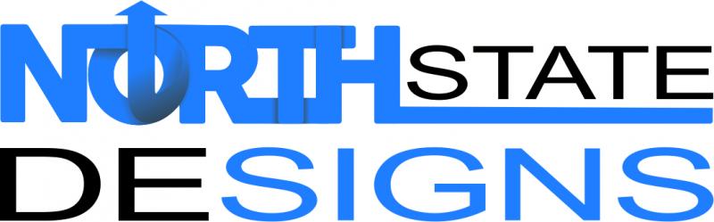

Warlick Designs
what about just removing the arrow..? and what do u not like about the "DESIGNS/SIGNS" PART?

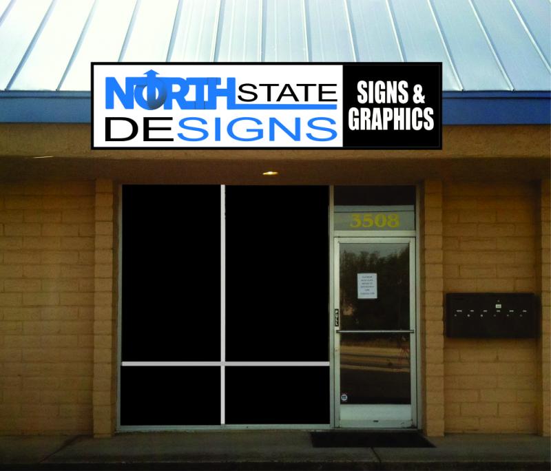

Joe Diaz
It might help to give those letters some room to breath. The space around letters is about as important as the letters themselves. I'm not saying you need to design an interstate sign, but have you ever looked at one up close while you weren't speeding on by. The space between letters are almost as wide as the letters themselves. Again, I'm not saying you need to do that, but understand that their is a good reason they do this, and you can apply that knowledge to your design work. If all else fails, do the squint test and see if you can read it. Hope that helps.
J Hill Designs
if you look at the thumbnail of your mockup on the wall sign, that is how people will see it, and it is COMPLETELY unreadable
:thumb:
do away with the black box with signs and graphics if they can figure out what you do fro DeSigns, then well they are not in the market for you anyway. I like the arrow on the N. i agree more spacing too.
