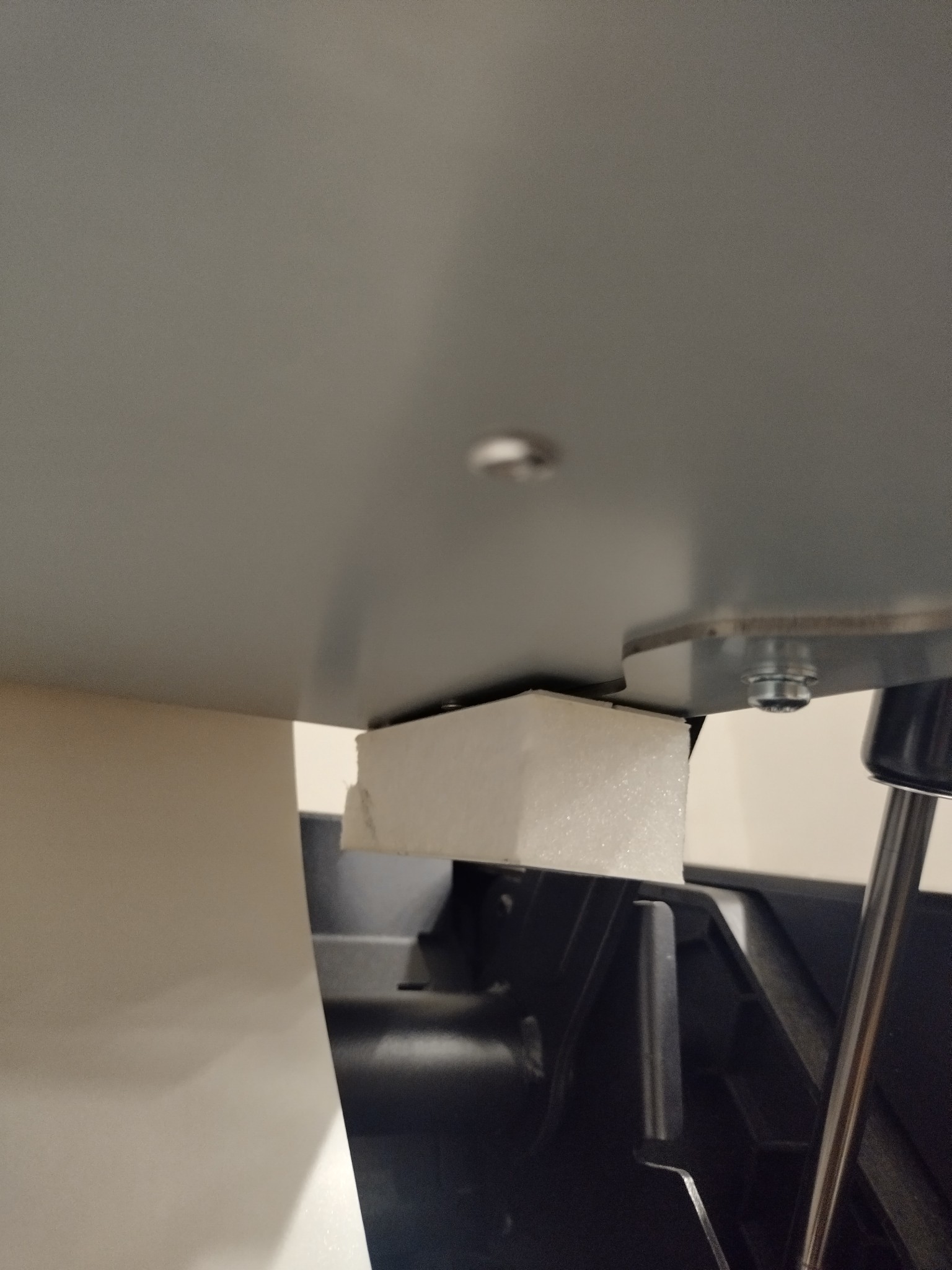

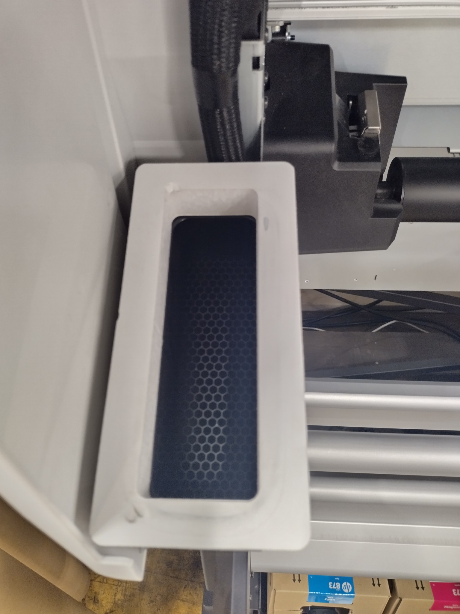

At my last job we had a Latex 260 and it was a decent printer the got traded for a 360 which the 360 got better colors and overcoat cartridge, then we got a 365 which is basically the same 360 with minor changes, then we got a 800 series and had trouble with it, it jammed to much and rubbed the media to much, I tried not to use it much; 2 years later we had expired ink on it but still prints, I realized that the drying area was an inch lower on the 800 compared to the 365, I made a jig to where I could print raising the drying module one inch and after that I ran it a lot more, I'm not sure if anyone else had this issue since the people that sold us the 800 could not fix, it is nice to have 3 litter ink on the 800, we did'nt have white ink on it, also the 800 you can turn the overcoat off but not on the 360's

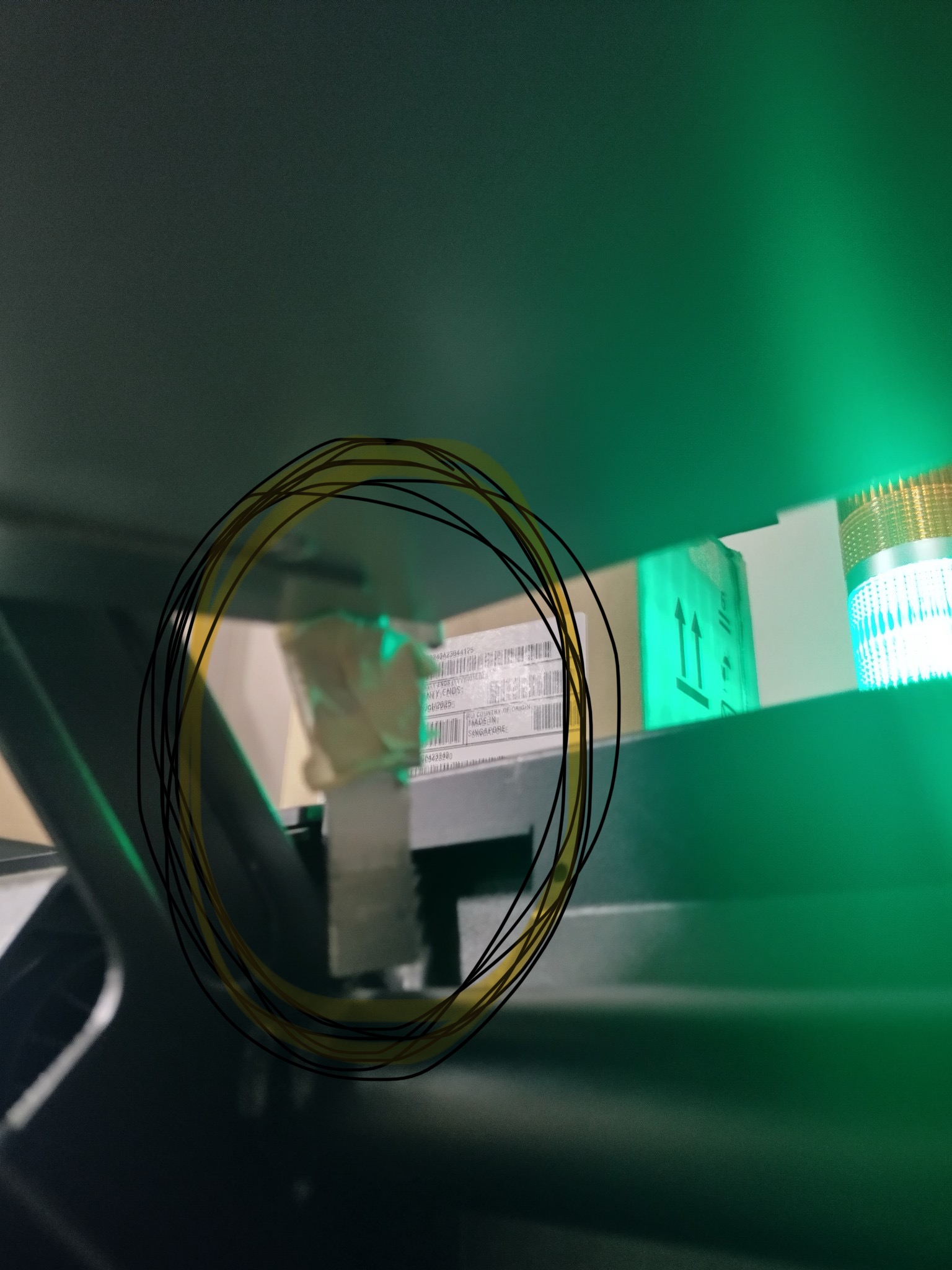

I no longer work at that place but I can try to get you some pictures sometime next week; all it is is a 1'' think block to set on the right side under the curing module to rest on, on the left side you'll need a 1" thick rectangle to the size of the air duct and on the same left side a metallic tab to trigger the sensor (witch I stick with double side tape), the printer will show a message saying is not a 100% contact HP but as long it let you print is good,

I got some pictures here
