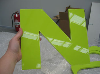

  16. g&eprinting
    g&eprinting Member
    360
    16
    Jul 21, 2011
    Everett MA
    Yes "rattle cans" they rattle so babies won't be scared to use paint.
    Just kidding you'd be amazed at the outcome.
    They have come a long way with spray paint.
    Up to 750ml cans (2 cans in one) every kind of paint and color.
    Translucent, transparent, opaque, effects
    I would only buy 4 regular cans for that at around $25 and probably use only 3 depending on how big the letters were.
    & I have all kinds of spray equipment but I'd use the cans, same outcome with tiny skills involved and less clean up. Yes there is very sh!tty spray cans too just avoid them.
    I know guys that can put a very large mural faster than digitally printing and trying to wrap a building and lasts much longer. Very beautiful thing to watch too. I know muralists that can hold your picture and paint it exactly on the wall. Amazing. I'm not that good with photos but, letters fades and logos no problem.
    A Dunknin Donuts that I did with an hour to inspection time on a dirty back wall that they would have lost points and bonuses for. Got 100% on their inspection and got their bonuses and so Did I. Ha Ha 6 cans at about $5 a piece for me, Lovely Day.
    Definetely not my best work rushing an all. Got the job done, on time, got paid and free coffee for life. These GM's make a $25,000 bonus a year.
    Breaking out the airbrush would have taken way too long.
