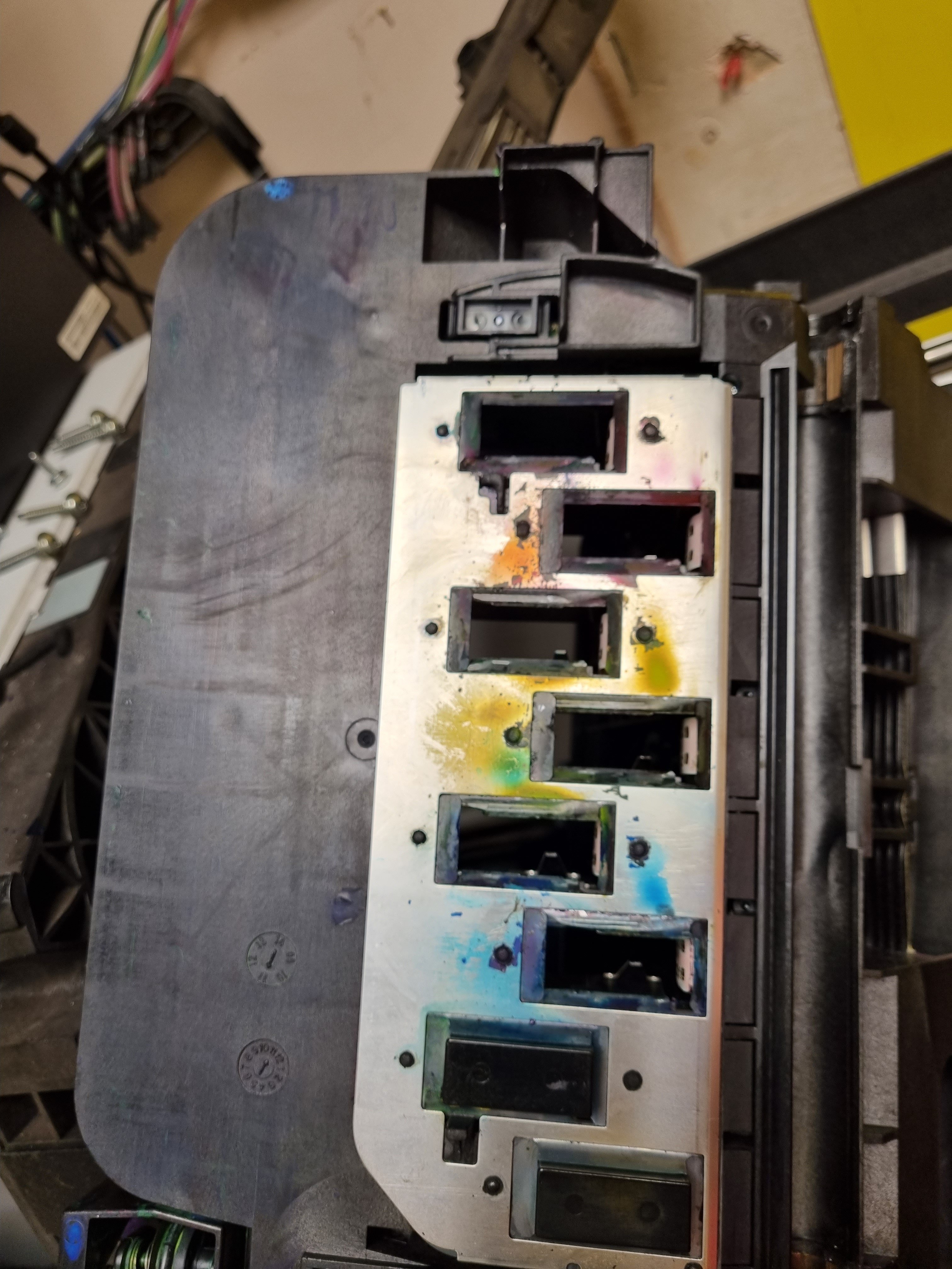

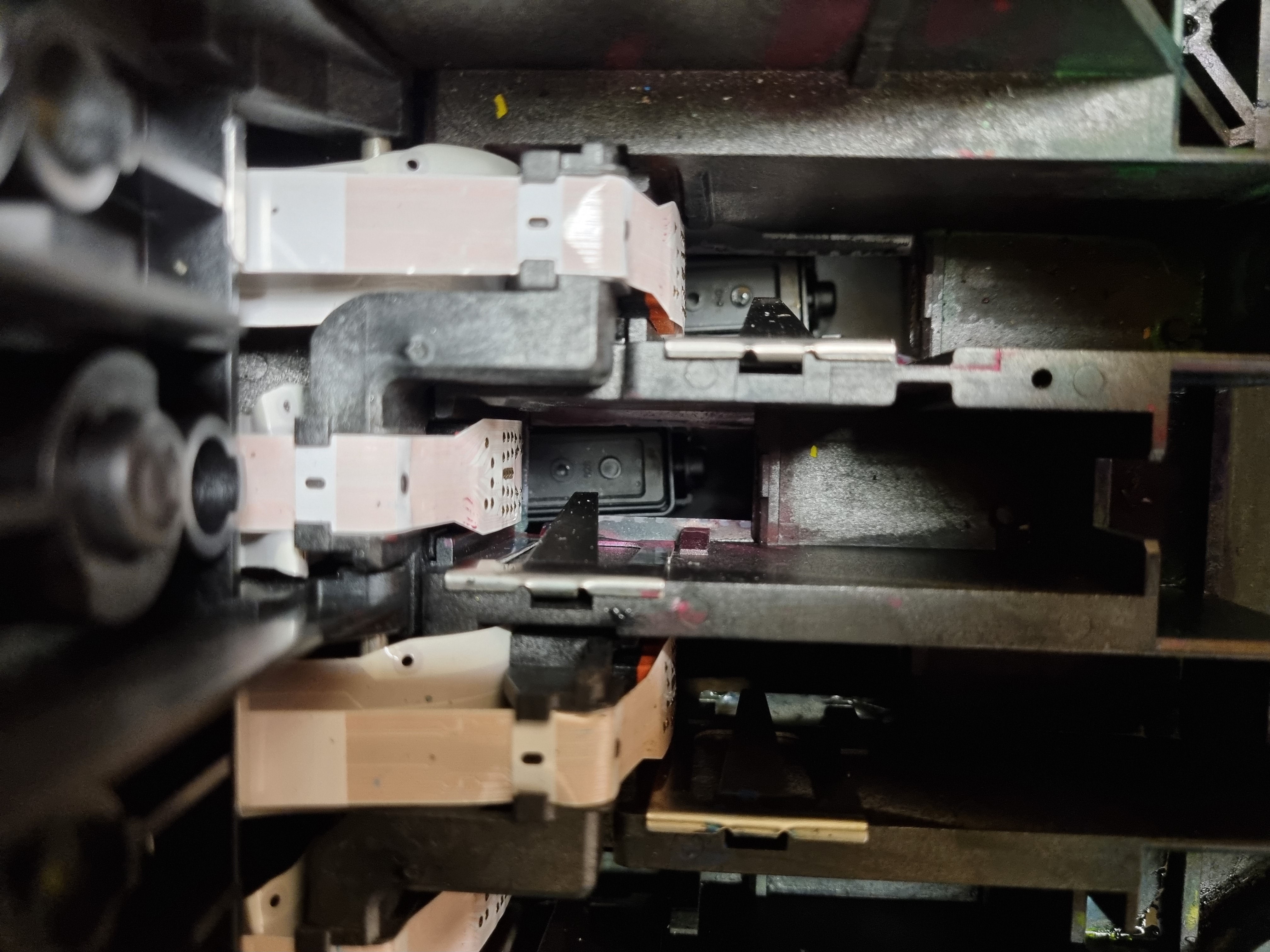

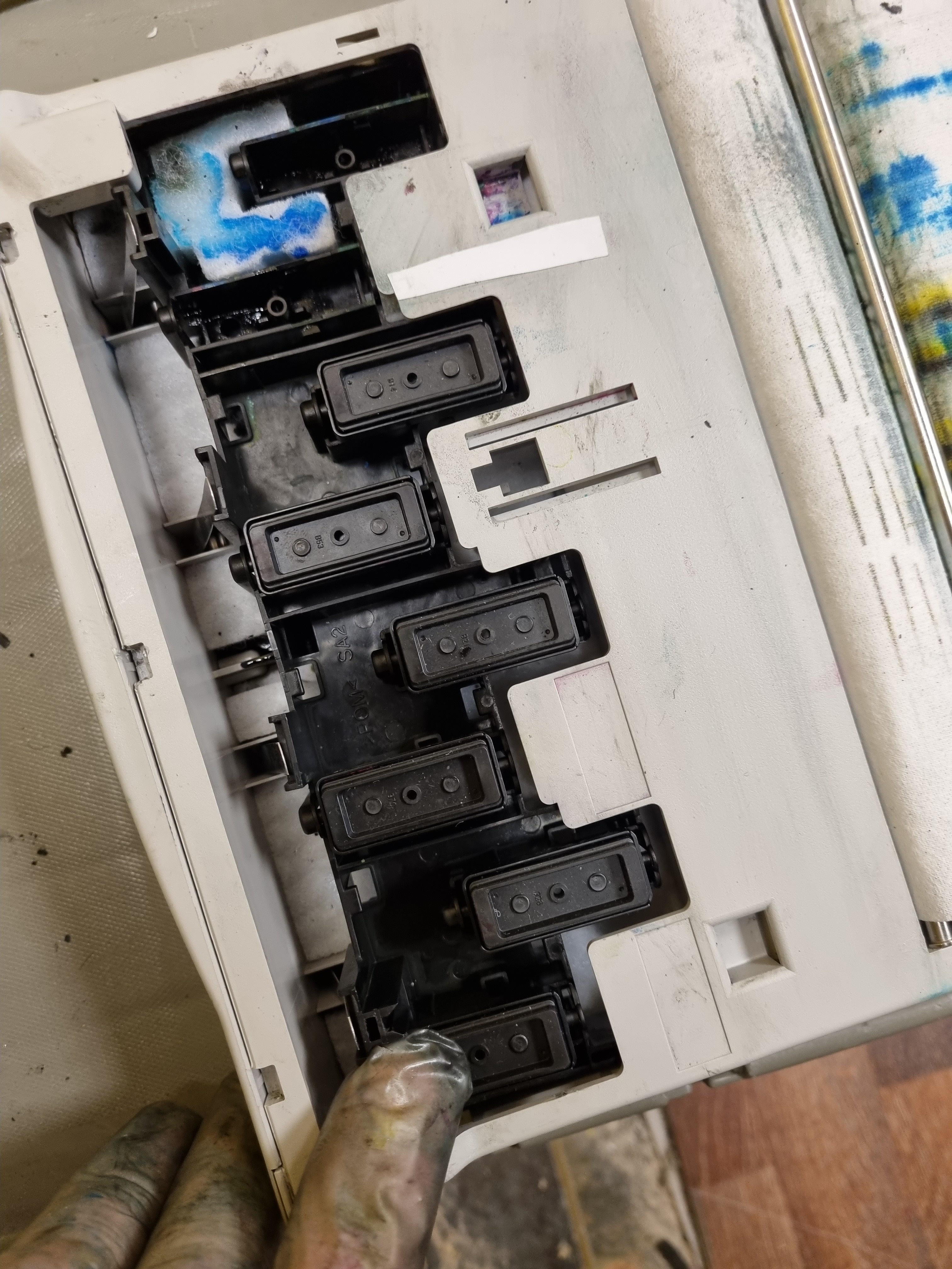

Well... meantime I've had a look on my l25500. I was trying to make it useful till I get a new one.
Managed to recondition the maintenance unit. However it was suspiciously dirty, basically flodded with ink. I've found few rubber pads off so the heads were not sealed properly while not used.
Put everything together but taken off the side cover this time to watch the whole process and clean the carriage properly.
That's what I've found:
Chris Formela

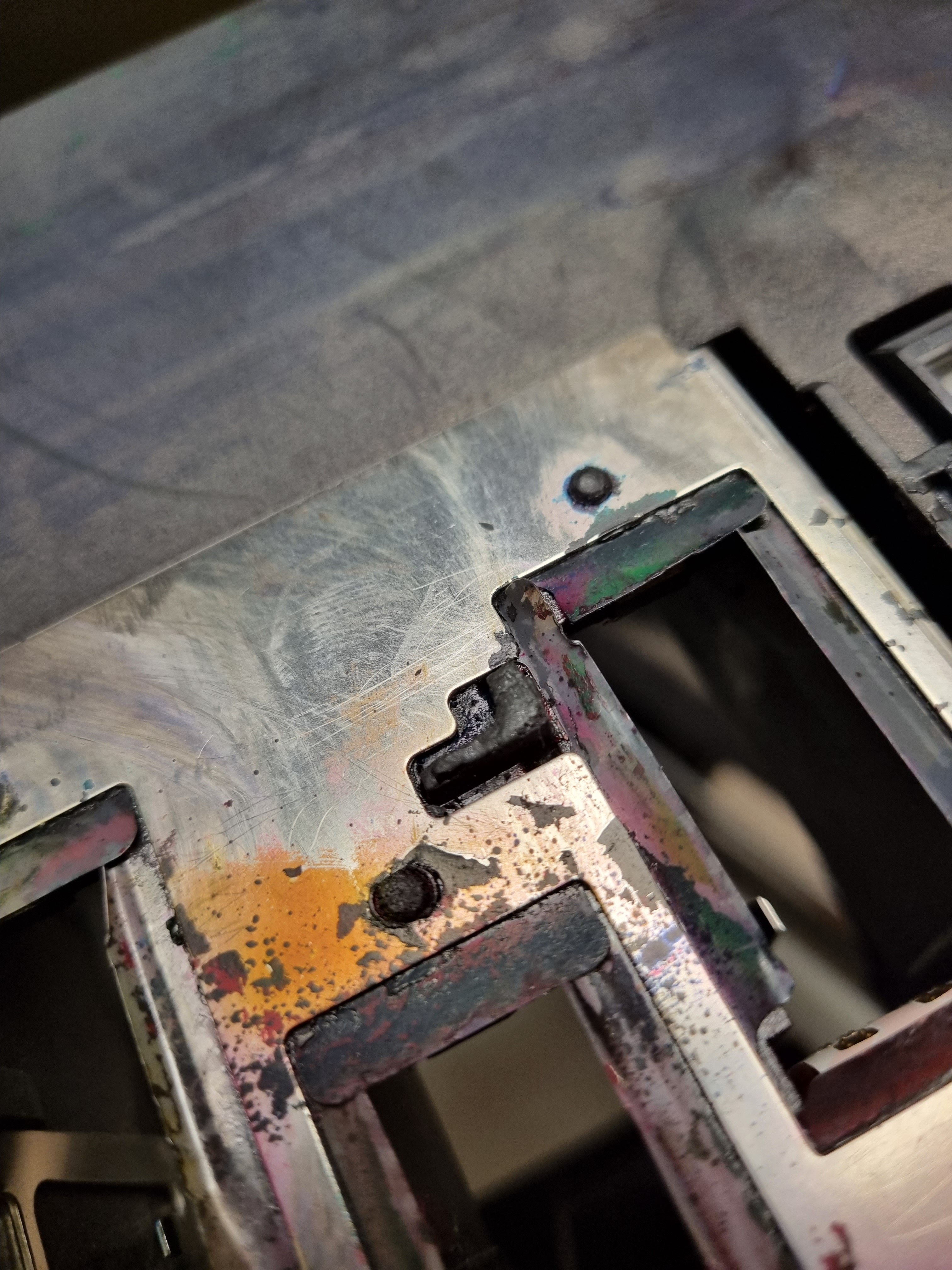

Chris Formela
Basically, missing bit on the carriage wasnt pushing the heads seals. Heads were staying constantly open and drying!
Ill try to reconstruct the missing bit with melted in thick wire unless someone here got L25500/L26500 carriage for sell at quite normal price.
