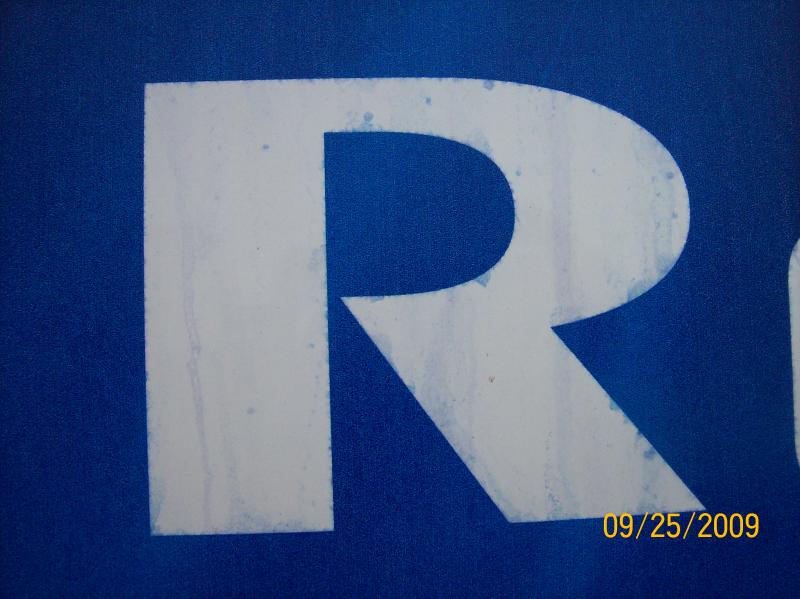

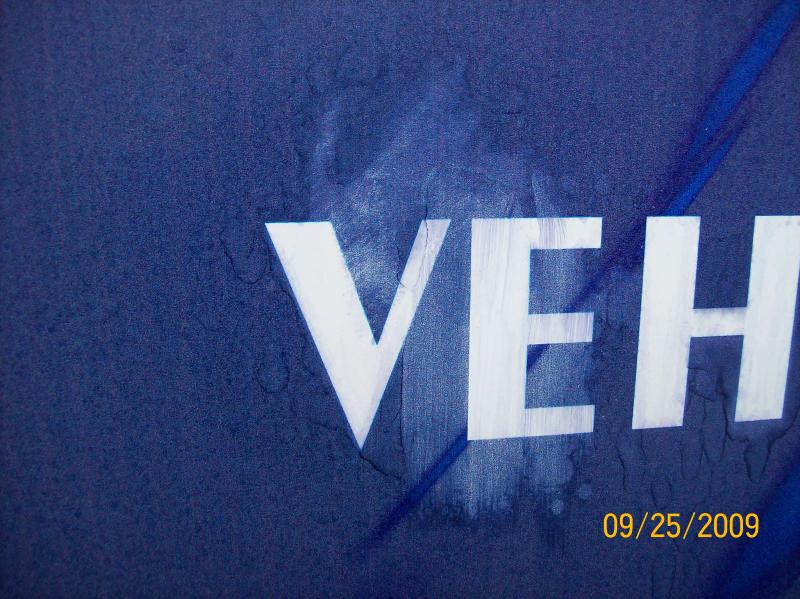

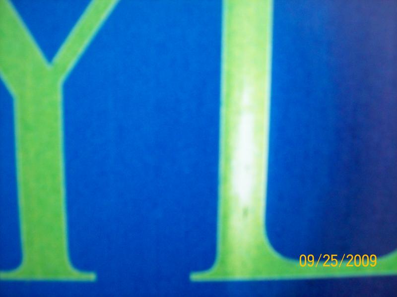

Here are pics of the fading. The ink also wipes off with a paper towel. :omg2:

Let me chime in here as I also own an Ion. I have experienced the same issues as mmorse and can verify the issues with fading after 6-9 months. For temporary signs it is great but I would not use it for anything longer than 6 months.
Here is information from Gerber's website
"Product life and outdoor durability: GerberCAT inks have a three-year, outdoor-durable lifespan without lamination. (With the exception of vehicle graphics; also recommended for lamination.)
I do not know how they can claim 3 years lifespan.

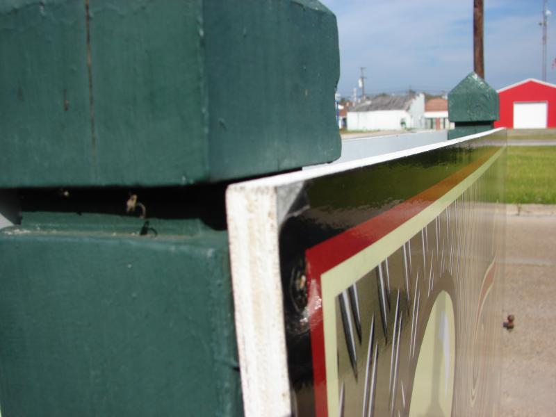

mmorse
FYI on the laminate be a protectant for the Ion ink
Well it appears as though laminate is not Gerbers solution to the ink fading issue.
We put up a sign less than a month ago that was laminated. It was printed on the Ion on Duraply. We went back this weekend to take pictures of it, cause it was a nice looking sign, only to discover that the laminate was peeling off the duraply in the top right hand corner, AND taking the ink with it.
