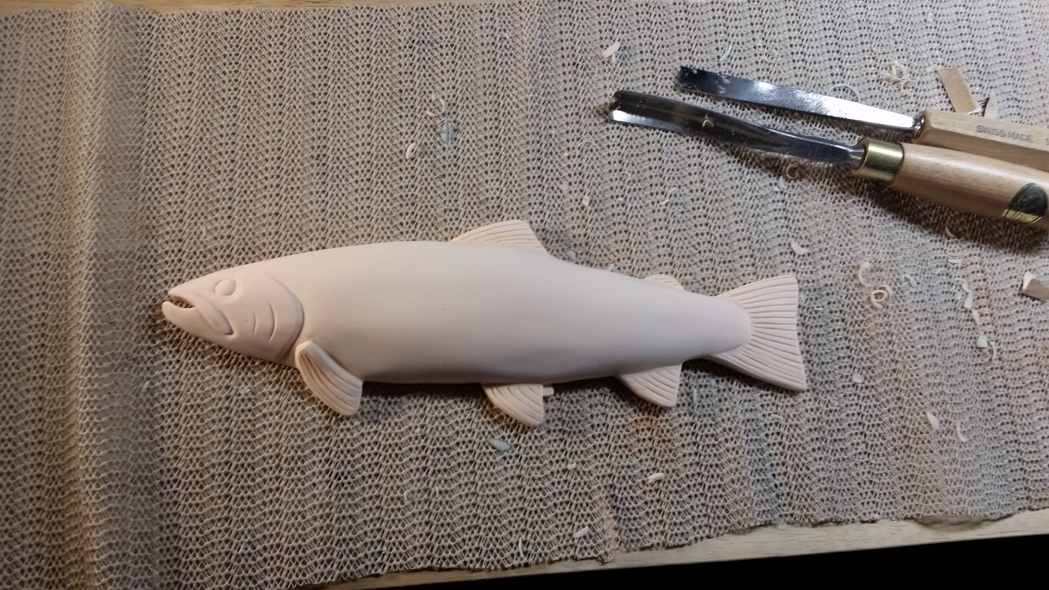

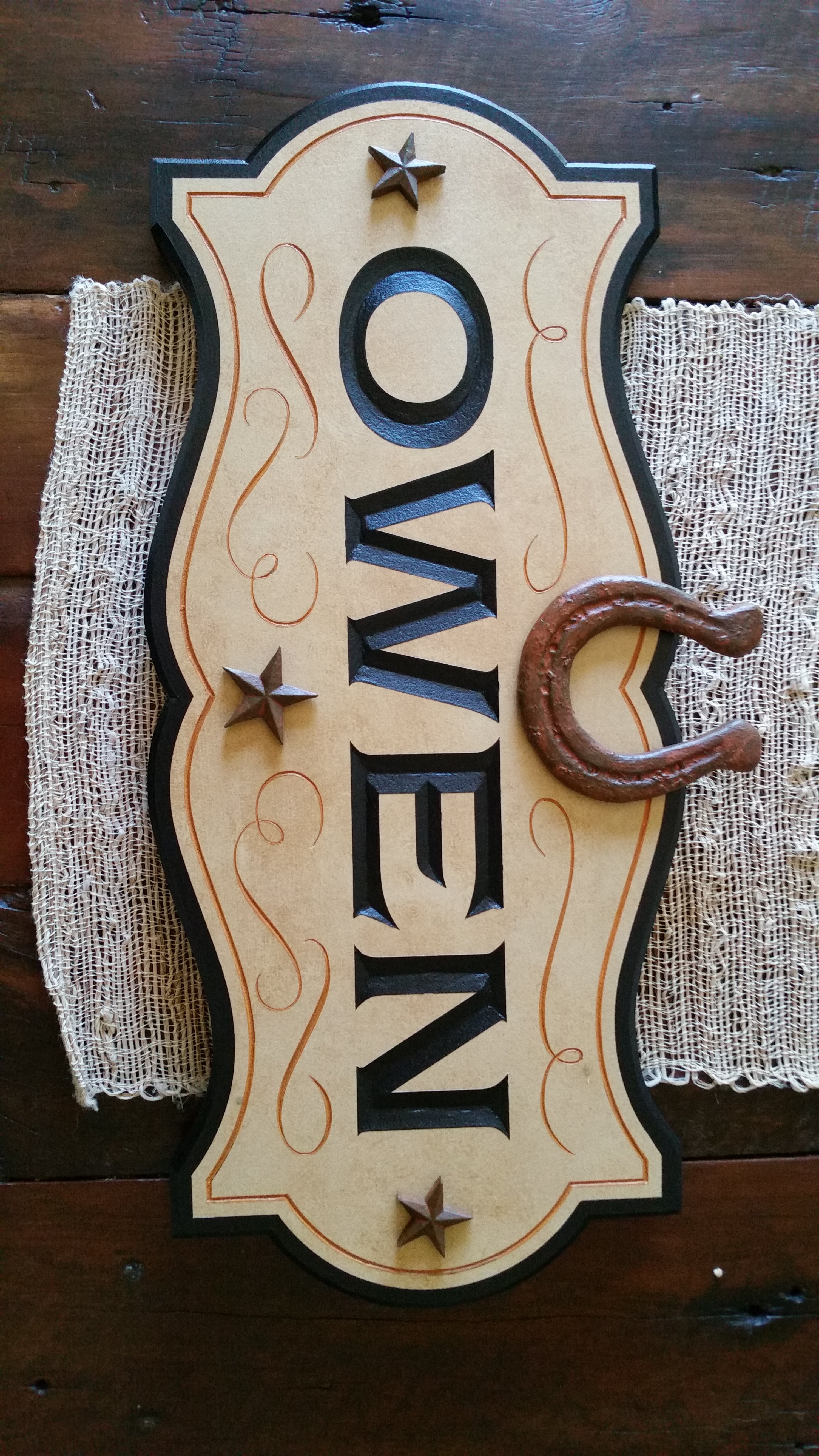

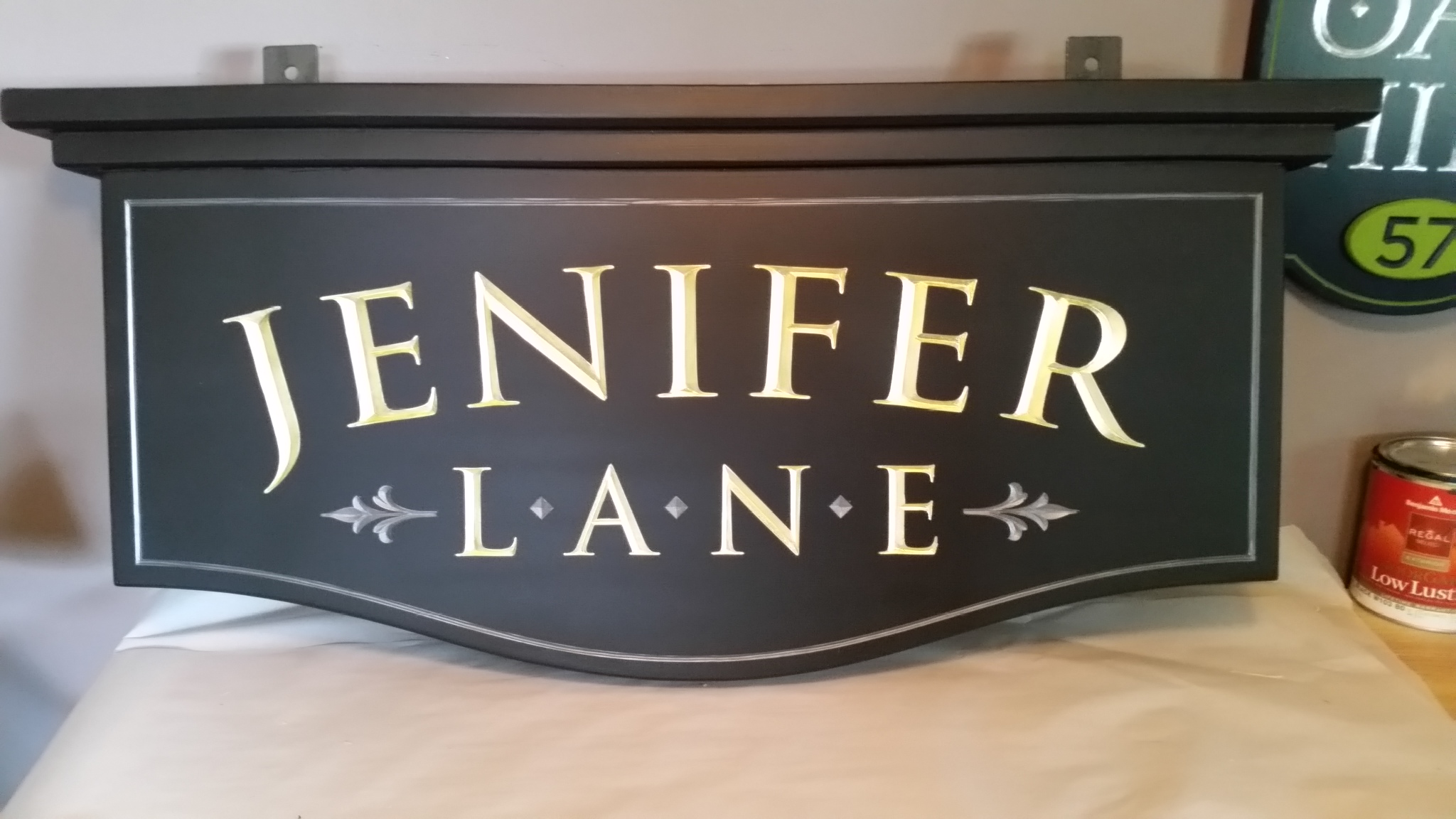

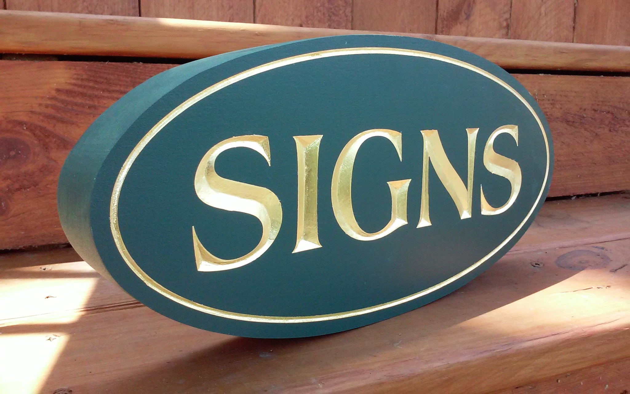

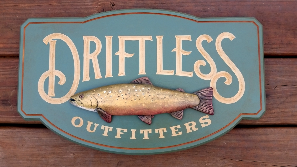

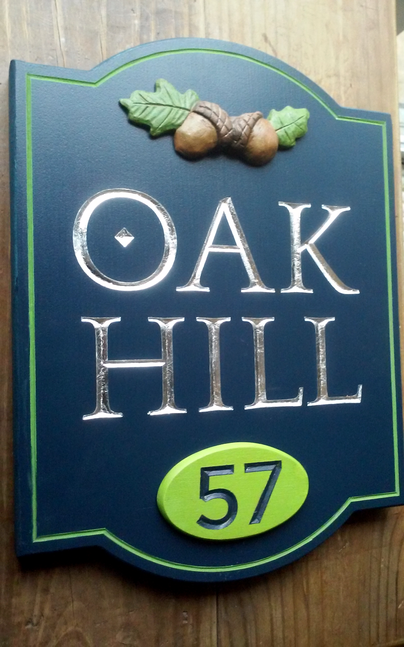

Pfeil tools are indeed great tools, I use them too. I'm a learner myself, but from the research I've done, sharpening doesn't have to be as complicated as many make it. I keep a buffing wheel on the bench and use it between each letter I carve, that keeps the chisels nice and sharp. I haven't used a sharpening stone yet. Although I've notice one of my chisel edges is getting a bit of a curve to it.
You don't need fancy chisels either. Adrian Page uses regular hardware store chisels and produces some of the best and classiest looking carved signs I've seen.
As far as painting goes, you don't need a fancy spray system. I've sprayed mine, but honestly prefer the look of a slight orange peel personally. It's a hand made sign, market it that way. It doesn't have to look like a piece of plastic.
I use acrylic house paints. I think you'll find they'll last more than 5 years as stated above. If the sign is properly primed/prepped, I wouldn't be shocked to see modern house paints last 10-20 years.

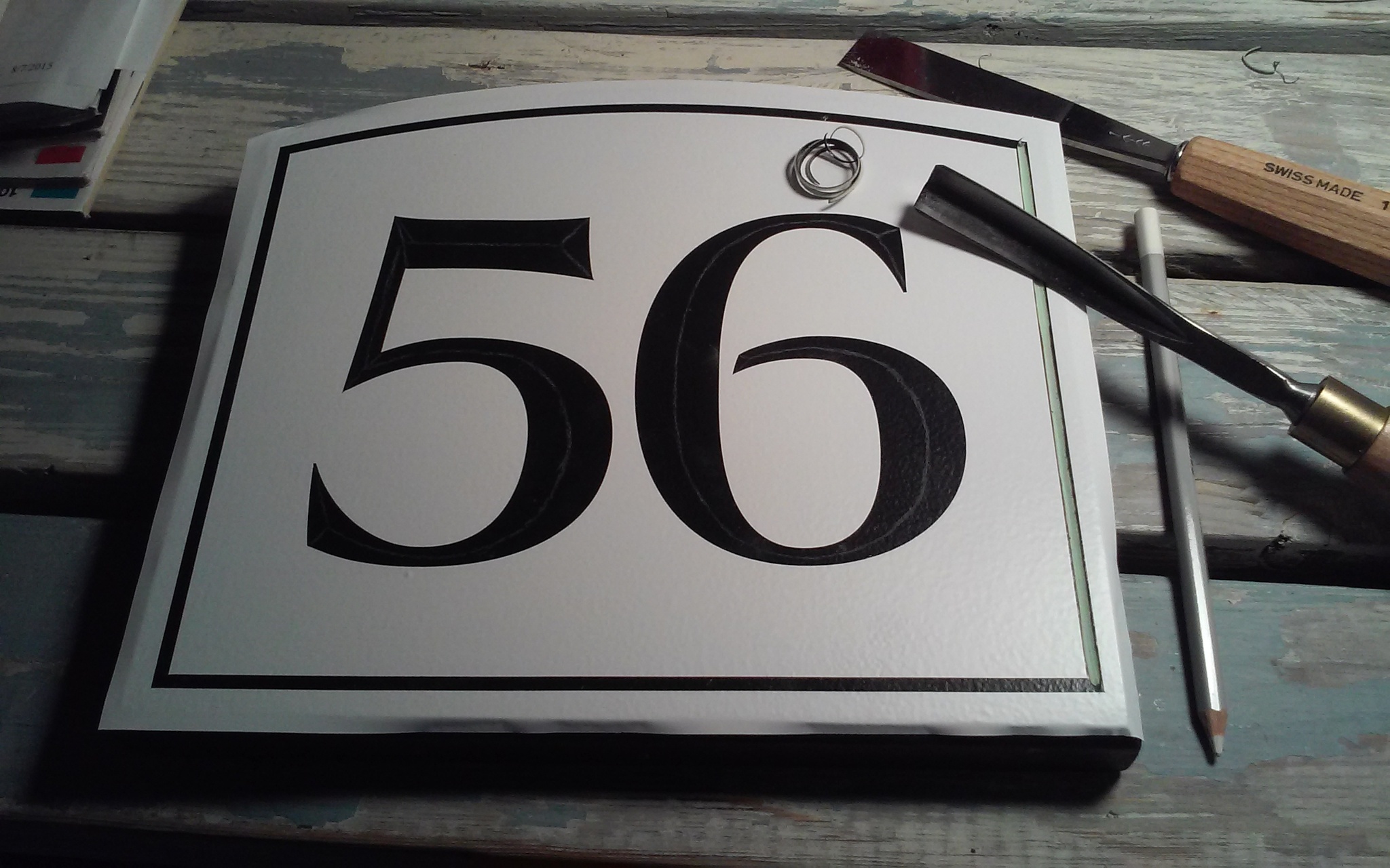

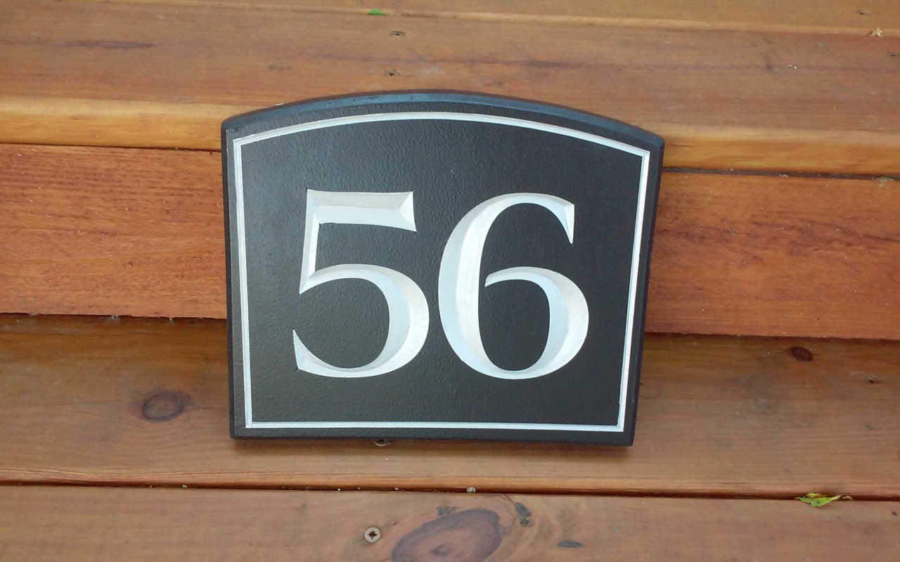

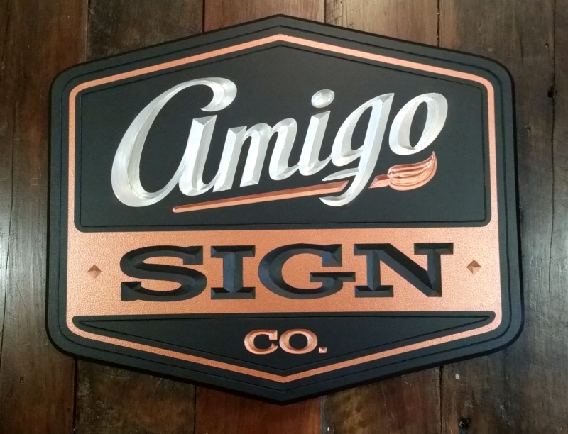

Here's a few I've done

Very nice. I have several generic carving tools - v grooves and chisels and a few cheap stones that I can try and put to use.
I too am a fan of the hand lettered hand carved look vs the manufactured look. For most of my signs I use Sherwin Williams exterior paint and it holds up beautifully.
