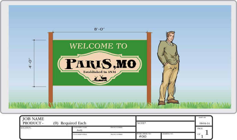

Attached is a quick layout, I didn't have your "PARIS" font, so I threw in the closest I had.
I know you didn't ask, but your layout was way too busy, the "Welcome to" was skewed and not
readable, Established in...." was off center, & you mixed different styles of clip art.
A 3/4 Green MDO with Edge capping , attached to two 4'x4' posts would be a much easier sign
to make and a much better product for your customer.....

i didn't think i could see a worse layout than the OP, but andy you amazed me....
$500??
really??
two sided 4' x 8' ??? i suppose your going to install it for free too....
WOW
Andy D
$500??
really??
WOW
I was working with the original layout, you think mine is worse?
I spent 10 min reworking it and it's a 1000 times more readable, how is that worse?
ddarlak
Go Bills!
10 minutes you'll never get back...
how is it worse???
hmmmmmm
MO for starters
second, you thought it looked good enough to post!
Andy D
Whatever Dude, I just removed the elements that I thought needed to be removed,
and if you had any reading comprehension, you would have understood
"I didn't have your "PARIS" font, so I threw in the closest I had"
That means I just threw it in to show some signs like these have the city and the state....
doooo youuuu unndddderrrstaannnddd nnoooowww?
Or do I need to dumb it down for you more?????????

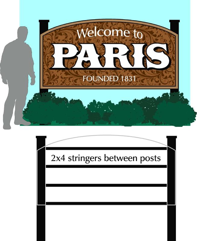

I think the MO is useless. If they don't even know what state they're in they won't be able to read the rest of the sign anyway. And pulling a custom shaped sign design on a rectangle just screams cheap assed town. :wink: Matter of fact, get rid of all that nature clip art, it's pointless too.
If you're doing a 4x8 mounted between two poles in 3mm aluminum composite cut into that shape go ahead and make a couple of extra ones while you're at it because they are going to warp to hell and back in a couple of months. Even if you move the posts inside between the two signs you're still asking for trouble.
Just a thought that simpler might be better. By the way, I looked up the Paris, MO website....they are using a picture of half of the current signs as the header on their website.

There are certain conditions in which you could do this 4' x 8' 2 sided for $500...... but quite honestly, why ??
If you had a flatbed printer, a CNC and was doing this on 10mm aluminum composite, you'd be fine at your price. Quite a bit under the normal market, but you'd survive.
Since it's been approached, the layout/design is not quite what I'd wanna see upon entering some county or borough or something. There is more space dedicated to animals which won't be recognizable at the sizes indicated and the font is also not a good one for welcoming someone to your town. Your priorities are kinda messed up. Really, who cares if you have moose, turkeys and canoes there ?? You are welcoming visitors to PARIS. That's your subject matter. You are entering PARIS. A moose or turkey subtlety in the background would be good, but not everything can become foreground material and not so many diofferent objects. It makes for poor flow.
At 2-sided 4' x 8' cut out and with not so many angles and crap, without posts and no installation should be upwards of $1,800. Just food for thought.
