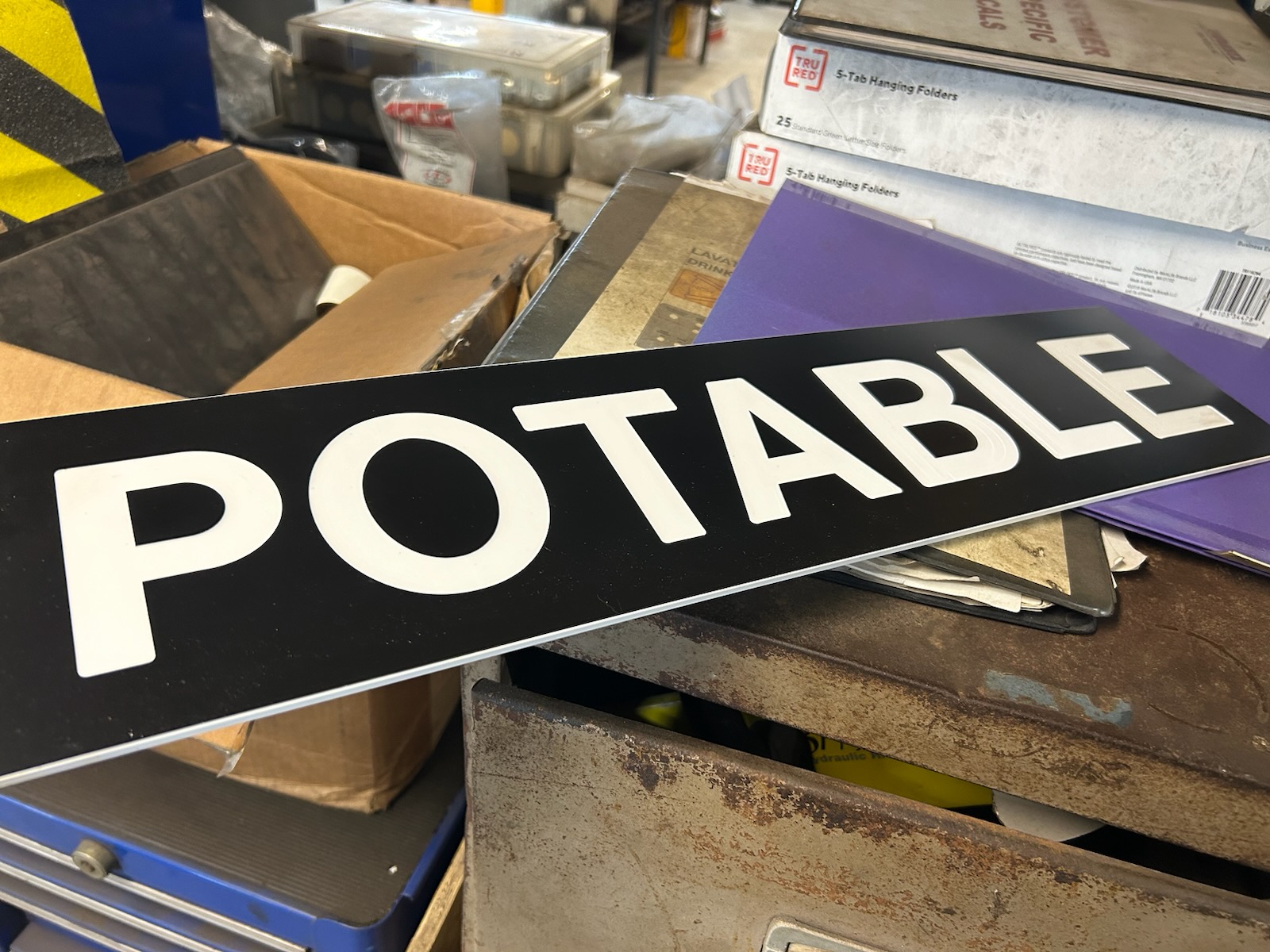

What's this called?
Notarealsignguy
Arial - it's almost helvetica
I'm trying to find a vendor that makes these. It's like a sandwich panel with the top routed out. They do not want vinyl, has to be this.
JBurton
Signtologist
Thanks everyone. Can it be routed with a straight or mortising bit or will that muck up the inner core?
Square endmill will avoid those stupid lines in it... I'd probably paint a sheet and carve the area out if they let me.
Rowmark is for interior only, it will freeze/warp/crack pretty quickly in outdoor environments. For a little sign its fine, not going to hold up for this.
