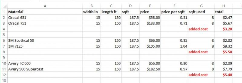

I was taught and agree that calendared vinyl doesn't belong on vehicles. Calendared shrinks and leave ugly adhesive dirt rings around the graphics, has a tendency to crack on inside sharp corners, and leaves the adhesive behind when you remove it. You don't really save that much by using calendared over cast and you have the potential to lose money on the looks, longevity, and removal. I have attached a spread sheet showing the difference in material costs on 1' x 2' two color logo on two truck doors.
In the end you should be able to sell the lower overall cost of ownership and that the higher quality will make their company look better longer (you only get one chance at a first impression). Save the calendared for banners, coroplast and site signs.
