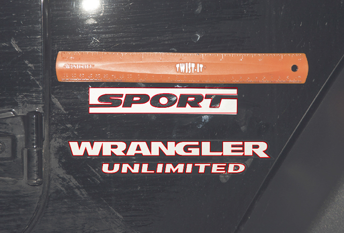

Most of the time I just use a tape measure or ruler (which I have attached magnets to the back), place it near the graphic and take a straight on photo using an 85mm lens (to eliminate distortion), then open the image in PS and scale to full size base on the full dimension. Then open the full size image and trace (dim the image to 50%) in Illy, bingo, I have a perfect vector image.
In the attached photo you can see how I created a full size Jeep Wrangler decal by first taking the photo straight-on (cater left to right, and up and down), with the magnetic backed ruler as reference, then scaled the image to full size in PS, then in Illy traced over the image to create the new vector file. One note, the SPORTS decal was installed crooked at the factory, that's why my red lines look off, because I made everything level.

also, without the right lens one can use PS:
- filter/lens correction/custom/remove distortion.
