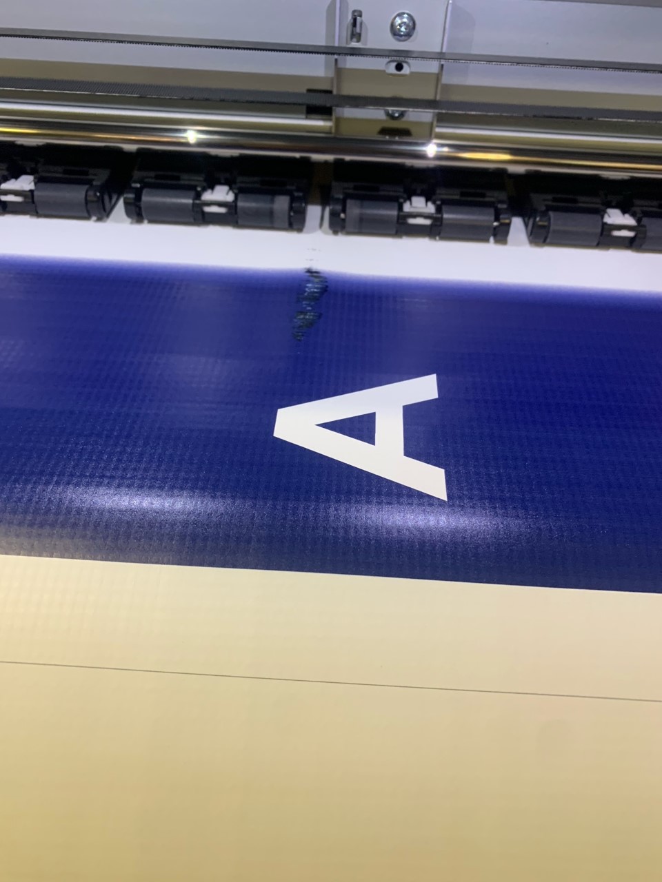

so we have an epson s40600 and love it no complaints....alwyas been a workhorse since we got it a little over a year ago but recently our banners buckle in the same spot non stop. I cant print more then 2'-4' without a strike....ive had cheap banner ive bought jet flex and others and same issue...i have turned off the heaters i cleaned pinch rollers and so on....mind you nothing and i mean nothing else buckles ... any help much appreciated as i seriously cannot even print a banner at this point and am completely at a loss for words - is almost always in the same spot as well which makes it more confusing

The problem is this has never ever been an issue until recently…nothing else buckles either I mean my shop should be same or similar temp and humidity and so on…also willl raising print head effect the print quality? I’m. Not even sure how to raise printhead heigh on the epson either honestly I’ve always been on mimaki

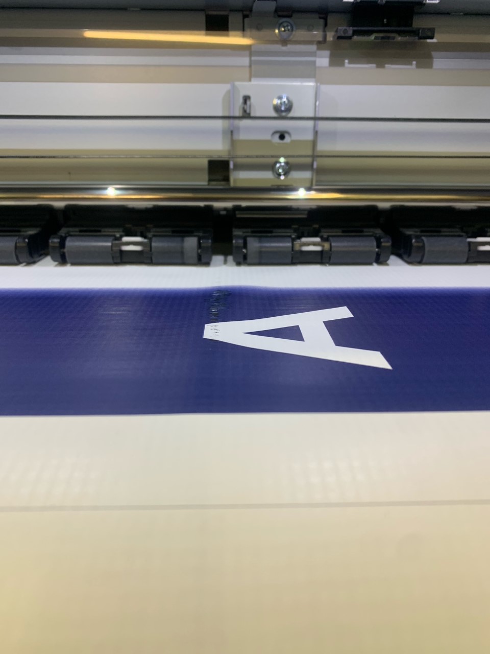

Maybe coming in from left field but look at the wear patterns on the 2 rollers that border the strike. They are the only two in the photo that look like that. Maybe swap them to the left end where you are not likely printing as much. Or split them up to each end. Could be the metal rod or holder is tweaked or just the rollers. If it goes away or moves to the new location get some new rollers and or assembly that holds them.

Banner will always buckle more easily than a paper/vinyl sandwich. You can tell that by holding to pieces in your hand. There are generally 2 things that will cause the buckling - #1 is heat, i generally tell people to turn it down 5 degrees C and this usually stops it. The second would be the pinch roller system not being balanced. I'm not sure how old this printer is, but could they need replacing?
Finally, with the banner shortages, are you using a different banner material than your used to? Not all 13 oz banners are created equally. I could just be that banner material.
I'm not familiar with Epsons, but I would bet that there is a carriage height adjustment. Check out your user manual, it should tell you. This is exactly why its there. And yes, having the head in the high position can degrade your print quality, but 1, this is a banner. Don't look at it through a loupe, look at it from 10 feet away; and 2, it will look better than the head strikes your getting now.
The head height is in the setup on the screen

Head height is in the media profile on the printer. Make a new media type for banner that turns off the first two heaters, post heater is fine. Run it on high head height, 4 pass. Calibrate it for the media and print.
It could be humidity or a lot of other factors but doing the above should solve your problems. Some rolls of banner just buckle worse than others. We had a roll of backlit banner that no matter what we tried it would buckle after like 6 ft. We bought a different roll and had no issues, tossed that roll in the trash.
