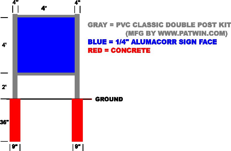

90mph at 6' above ground on 4x4 rigid vertical plane is about 530 foot pounds so you need to have posts capable of supporting a sustained load of 270 pounds constant (figuring 2 posts). I think a 4 x 4's load rating is about 650 pounds. (Mechanical engineering was a llloooooong time ago).
Hire someone to break down the numbers.

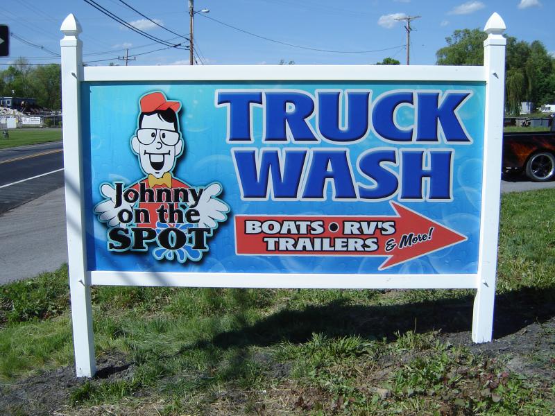

One of these signs requires engineering, the other requires only common sense.

This (along with the documents that I provided from the manufacturers of the products) should have been more than enough for somebody to sign off on this sign.
