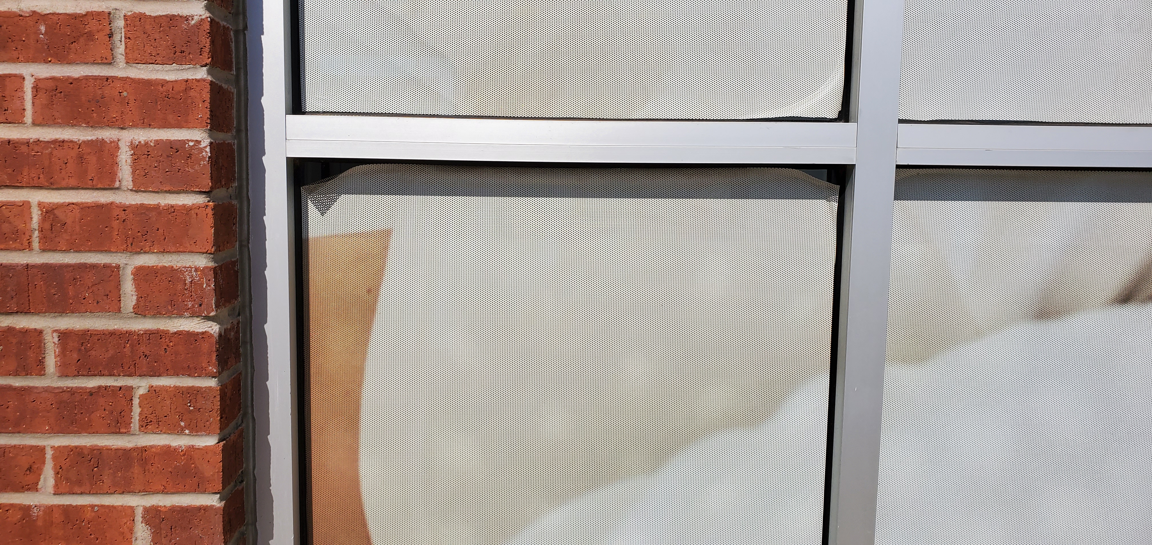

    I have some window perf that was installed this winter. One of the panels has some lifting in the corners. I prep the corners pretty well because it's happened before and the glass feels slick. Is there anything I can do to fix this? Can I spray adhesive on the back and re-stick it? Do I just need to redo the whole thing? I'm afraid if I print just one panel that the color will no longer match and this window is part of 20200804_163900.jpg

    Use some edge tape. 3m recommends (insists, more like.it) that you use edge tape on all window perf installs.
    If you.dont have any... All it is is optically clear overlam. Cut some thin strips and apply it to just the edges and it'll hold the corner down

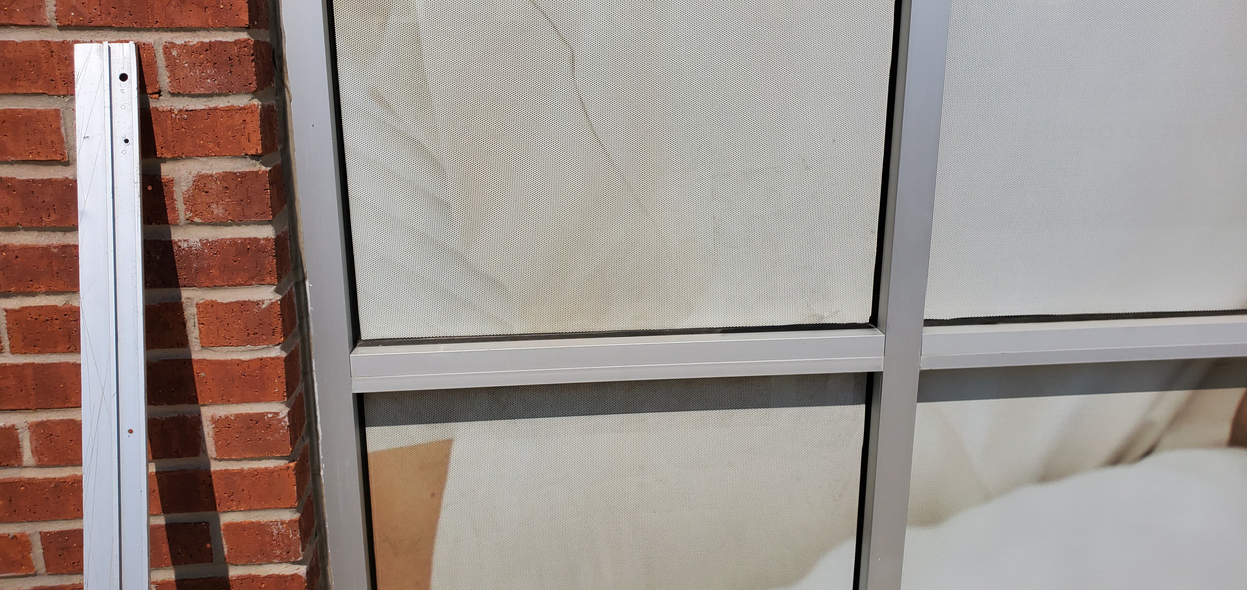

    It looks like the top left panel also has some lifting on the bottom right... and the bottom right panel is starting to lift too.
    It may be an optical illusion from the photos... but are you wrapping over the silicone? it looks like it's a quarter inch over the silicone in some spots. 3M again recommends cutting 1/8" away from the silicone because the moment the vinyl touches silicone,the glue wont stick to anything else. Another rule we never listen to... we usually squeegee to the edge then trim away as close to the silicone as we can. But if we slip and the vinyl touches the silicone, it's usually game over for whatever touched it.
    I'd say your best bet is to trim away as small of a section as you can and put some edge guard on it, hope it prevents it from lifting

    Yea I trim to 1/8" from the silicone. I use a straight edge and just go along the sides just inside the edges for that reason. I'll trim a little and use edge tape and see how that holds

    issues like this usually come from trimmed perforated material having little "fingers" with very little surface adhesion. all it takes is for a couple to start lifting, and then the sun/weather forces them to curl and then it curls more and more until the corner/edge is shriveled-up/curled-up.
    this, paired with the fact that glass expands/contracts with temperature and if you apply graphics all the way to the edge of the window seal, then as everything moves around your vinyl is getting pushed against the seal and causing it to start lifting in that fashion as well.
    you may be able to salvage your graphic, by flushing the area & vinyl with application fluid, to clear any dust/debris, and then using a heat gun with application fluid to "train" the vinyl to lay back in place. finish with more heat to dry & confirm it sticks and then trim 3/8"-1/2" away from the perimeter and finish with edge sealing tape....which is basically just optically clear overlaminate @ 1/2" wide.

    Yea, the corners are where I have trouble areas. Not all my windows did that but some of them. I went out yesterday and pulled back some of the vinyl, sprayed it with iso alch. and wiped the backside of the vinyl. That restored some of the sticky and I cleaned the corners out real well. I like the idea out the clear VHB tape, I might do that. I did some edge tape but I hate how that looks. It's glossy and brings weird attention to the edges.
