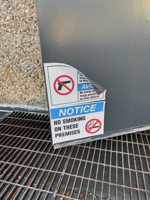

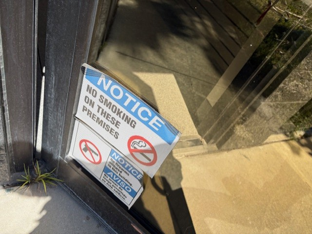

How did this end up after all? We're getting complaints from a client self-install about peeling and I'm wondering about the solution. We print and inventory these to send out to locations on demand for self-install. These couple decals are local, so do we just supply them with new ones, or will edge seal tape fix this? I am now aware of 3M 8514 edge seal tape, but these seem a little far gone. We may include an instruction sheet "Do not touch within an inch of the adhesive edge. Use included strips of edge tape to seal all 4 sides." Any other advice?
That seems irregular. Specify to applicator to use 70% alohol to the area where they are applying. Other cleaning products will leave residue, that will hinder the adhesive from attaching properly.

Are they laminated? It is odd that it appears most of the issue is at the top and bottom and not on the sides.
I wouldn't recommend putting perf on anything other than glass....it appears the metal surface has some texture to it. Seeing that you have anywhere from 30-40% of the graphic with no adhesive, that is asking a lot for a good adhesive bond.

Thanks. These are not laminated, and weren't intended for install on a metal door (the dreaded self-install wildcard!) We may pivot back to rigid board, mounted inside the window. I'm still looking for a window perf that I can print and mount inside the glass.

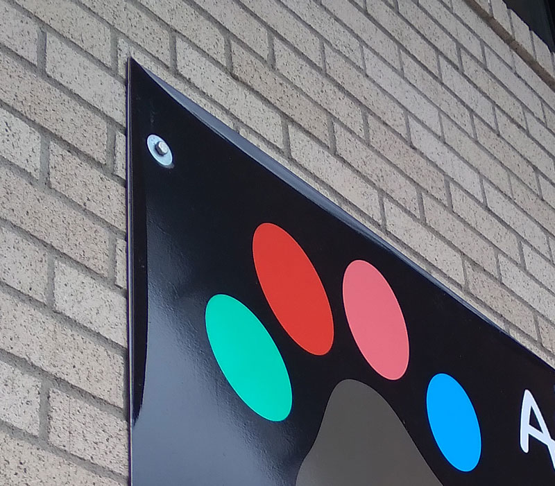

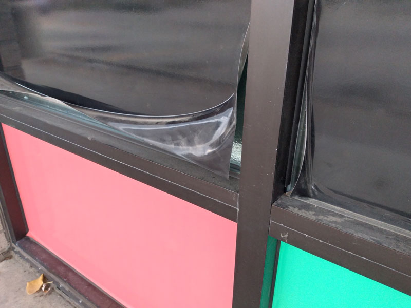

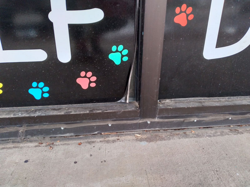

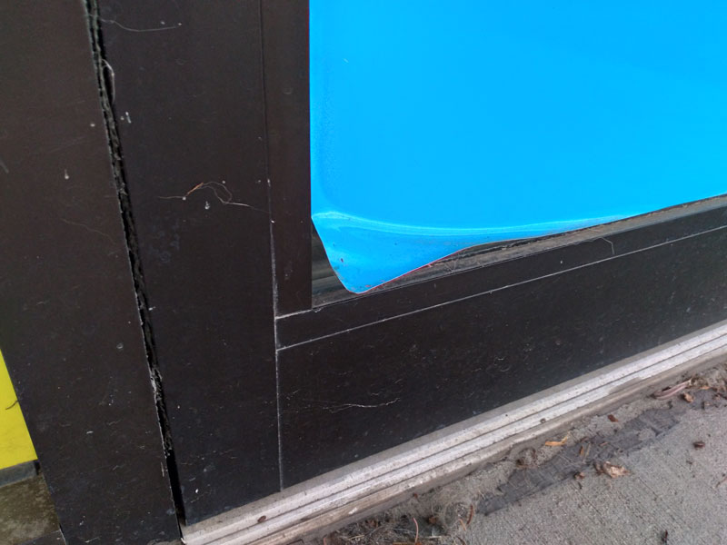

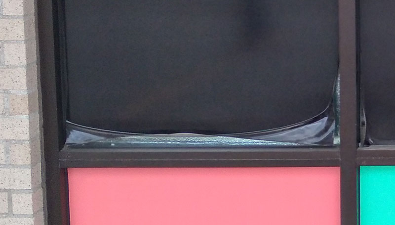

I checked out the peeling vinyl yesterday. It's all 3M IJ35C laminated and was installed by another shop in 2019. Nearly every window is starting to peel in the corners, mostly at the bottoms, and one in particular is all peeled up along the bottom and warped by the elements. Even the sign up on the building is starting to peel along the top edge. This seems like a material defect and not an installation mishap - what do you think? The windows face east.
View attachment 156129 View attachment 156130 View attachment 156131 View attachment 156132 View attachment 156133
135 is at its lifes end 5 years is up
