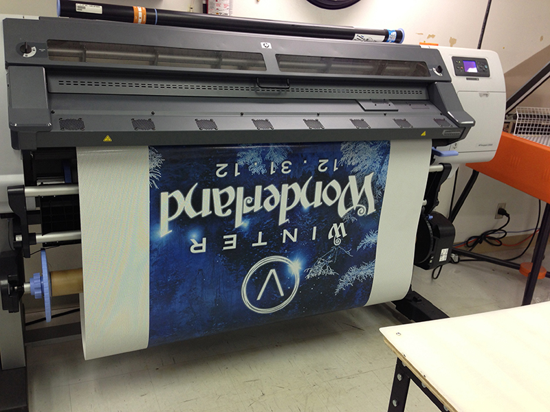

So, I have found this AMAZING new (to me) window perf product for the L25500. It's called ContraVision Performance. White on Black polymeric vinyl with Grayliner. It prints absolutely beautifully with the Latex inks (once I get the printer to recognize that it's actually loaded!!) :banghead: Which leads me to my question...
Has anyone had issues loading window perf on the L25500/L26500? It loads just fine, but when the head comes over to scan it, it gives an error message saying it can't detect the edges of the media. Now, maybe the solution I am using is the proper one, but am wondering if anyone else has ideas. What I did was run masking tape up both outside edges around 3 feet... the printer then seems to detect the edges and it loads fine. Then I just advance the media... peel off the tape, rewind the media and print away! :rolleyes:

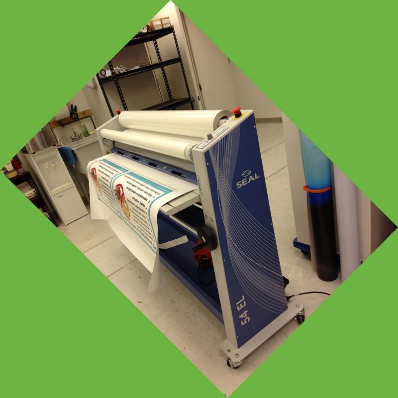

I have attached a pic of the beautiful print. This is one of three panels I am running. 37.5" x 91" finished size each. I am laminating them using a product called DOL 1560 Optically clear laminate. Laminating them on my BRAND NEW Seal 54EL Laminator :clapping: Runs like a charm and laminates like there's no tomorrow!
