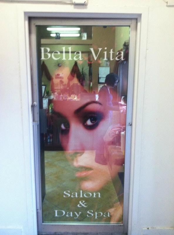

I know this is an (older) thread.....but that first picture - is that really just perf? Can't wrap my head around it.
Definitely a neat effect regardless of how it's done.

Yes its only perf. If you print black or any dark color you can see through it (provided lights are on in the building) just as if you were looking through the other side of the perf. There is a black background in the photo, that is why you can see through it around the girls face.
