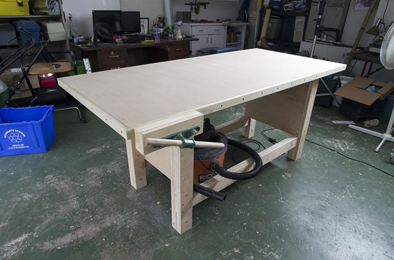

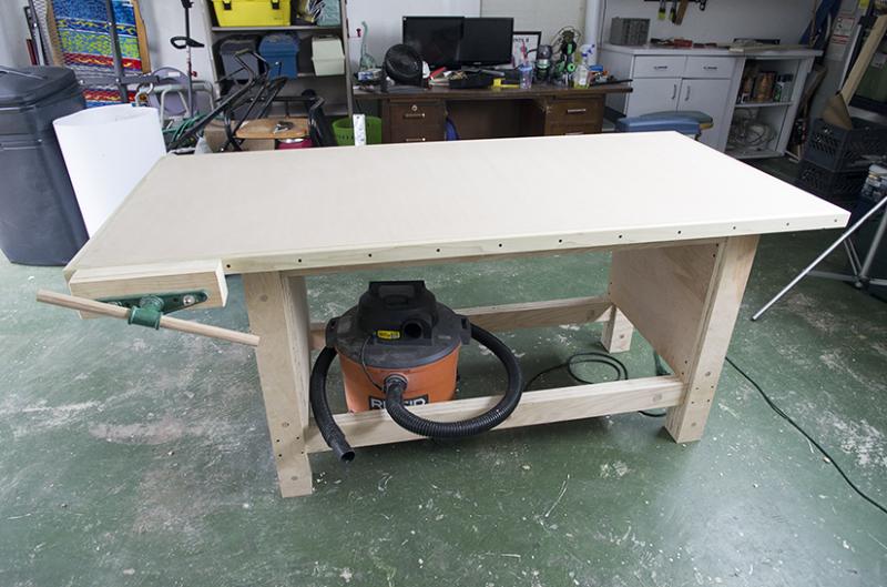

I thought I would share some photos of a workbench I just completed for the garage. The project was cut entirely on the CNC from 2 sheets of 3/4" plywood and 1 sheet of 3/4" MDF. The edging around the work top is made of poplar. I found the plans on the internet and adapted it to CNC using dowels to align the pieces during glue up.
