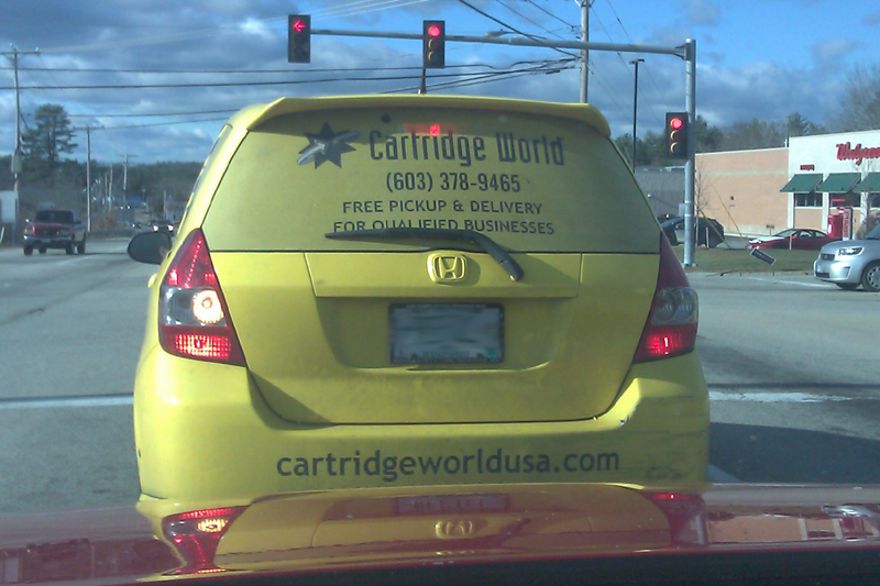

Saw this today. They wrapped right over the Honda emblem!

Where's the fail?

Not the nicest design I've ever come across, but the install looks pretty clean from where I'm sitting.

Install actually looks pretty good around the emblem!
And it's pretty common practice to wrap over emblems on some vehicles. Many times customers don't want them removed for various reason (leased vehicles, temporary wraps, etc).

We wrapped 4 of these for cartridge world. We had to wrap over the emblem as well, we were forbidden to remove them... didn't ask why..
It's pretty common believe it or not.

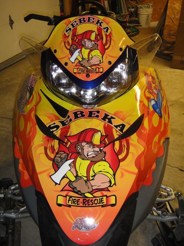

I just finished this wrap on a Polaris snowmobile and left the emblem on as well. In this instance it sits in a recessed area (right below my logo) and when the rescue department decides to no longer use this sled it can be sold without the hole. Very common practice to leave on the factory markings.

Excellent work - love seeing the sides and hood matching up. Takes a bit of extra effort to make that happen and look right. :thumb:

I've always wrapped over emblems, most customers I talk to dont want stuff taken off the vehicle. If emblems are done good its no different than a door handle, mirror or whatever.

I use "fail", never "epic fail". Fail has been used for years, such as "dude". The internet has just ruined it. As for the emblem, maybe you can't really see it from the picture, but between the Honda "H" has been cut to lay flat. So the wrap goes on the "H" and the outer ring, then it was cut and the pieces taken out were then applied in between in the holes. Then around the entire emblem it is all bubbling up. They didn't stretch it around into the holes

in most cases i remove it and re install over the vinyl, provided the artwork will allow but if you can install over it and you get it to look good have at it. ( i still need mor practice...haha)
you could see all of this while sitting in your car 15+ feet away? talk about hawk eyes:notworthy:
