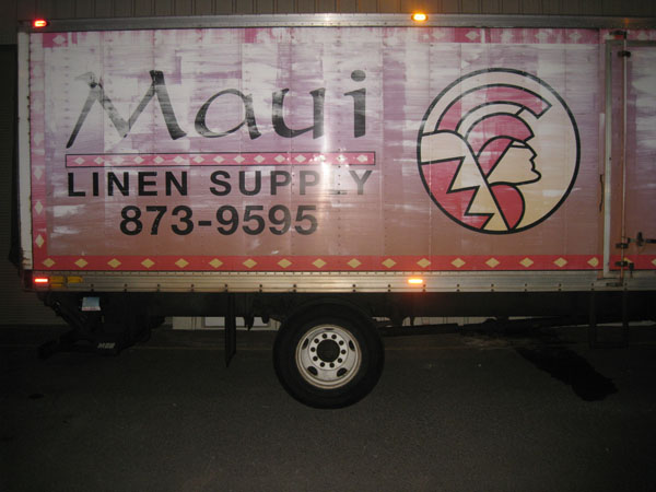

wrapping over a wrap... any specific concerns I should be aware of?
iSign
I've printed everything on IJ180C, and laminated with Oraguard 290.
I'm doing a 24' box truck & it has been wrapped before. The colors look pretty shabby because I think it had some kind of liquid laminate brushed on, which seems not to have worked, but it looks like a good air release vinyl, sticking well, and conforming well around rivets.
I realize the possibility of a liquid lam makes this question a little harder to answer, being an unknown substance, but besides that does anyone have tips or tricks I should know? ...or concerns?
The reason I suspect a liquid lam is all these lines like brush marks... at first I thought it was scratches from scraping past brush & stuff, but then I realized it looked like brush marks
ProWraps
that liquid lam is going to be a major fail if it fails. as that stuff gets older it tends to crack right off the prints its applied to.
be careful!
iSign
it actually doesn't look like any lam is there... certainly not enough to crack, but there are these mysterious scratches. Ever seen anything like this?
DucatiDave
did they run it trough a hot laminator without a laminate on the print??????? Those are PERFECTLY horizontal...they are not likely caused by the environment b.c there would be variations in directions...
Could be bad material that had marks from the factory that was printed on and then didn't bond with the vinyl in certain spots...but in my years I have never seen that before...but remove it, don't wrap over it...that will come back to haunt you...
Fitch
Doug do the right thing and rip it off... but then the client may be happy not to.
I would get a waiver saying that if the new wrap fails due to previous liner - "your fault"
Either way I would not warrant past 6 - 12 months, Probably only warrant the new print anyway.
Cheers - G
Circleville Signs
I would not warranty ANYTHING that I couldnt' inspect the paint on. If they insist that you install over the old wrap, then as Fitch stated, they need to sign on a waiver stating that there is no warranty, and that they went against your express professional opinion in the method of installation.
Letterbox Mike
No way would I wrap over that either. Aside from the obvious issue of the unknown substance on the surface, the old vinyl is starting to tent pretty badly over the rivets. By now in those areas it's probably brittle as well, so it won't take much for it to crack and start flaking off. When you're applying your new vinyl over it, chances are good simply by squeegeeing the rivets you're going to damage the underlying vinyl and cause an extremely premature failure of the new wrap.
But not to mention, you have no idea what's on the surface. Something obviously is, but I wouldn't gamble with my reputation by wrapping over something like that.
Look on the bright side, you could upsell them a good chunk to remove the old wrap...
This might have some bearing... what does this truck do for a living.... you know the owners ??
In the meantime, I totally agree with the others.... even if the customer doesn't want to pay you to remove the old vinyl, I would not double-dip the new good stuff on there. Sounds like a complete recipe for disaster by the looks of your second picture.

It almost looks like they didn't laminate it, and then cleaned it with horizontal strokes using some sort of solvent that wiped off the ink. That, or the roll of material they printed on had some sort of residue, or wasn't intended to be printed on in the first place and as time has gone on, it started to look like that.

I would suspect they used a foam brush to lay on some liquid clear. Where the clear is less thick the ink has faded more. Personnaly i wouldn't install over this. The chances of failure (sections or whole) are to great.

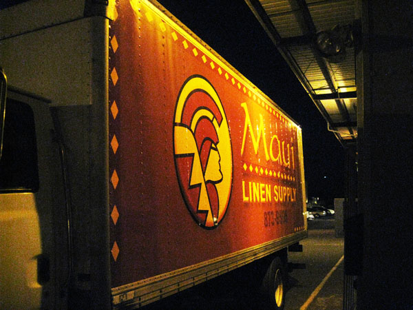

I never got a photo of the old wrap until tonight. I only did one side, so I shot a pic to show you the guys logo as of yesterday. He didn't have any art, so I redrew the logo & the word Maui. I decided to offer him some tweaks too, so I made him a little sign for his office. The third pic is where I stopped working at 8pm.,.. another of many 12 hour days here this week, but good money was made, & I will have 2 more of these trucks to do as well, (and of course the second side of this one!
